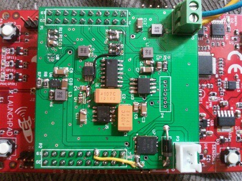

The original concept for this project was to develop a wireless node capable of determining PM10 and PM2.5 levels. The PM10 and PM2.5 quantities are globally recognized as the standard for measuring air quality, and as such the demand for robust embeddable modules is increasing. A CC3200 launchpad would be coupled with a particle counting sensor and a pump to create the node, and it could be embedded into any unit a user desired for monitoring air quality. I'll take you through the project progression chronologically (First blog post introduced my idea and disclosed my credentials). Below is a picture of the Air Quality Node created from a custom Booster Pack PCB and a CC3200 Launchpad. Note, the sensor and pump are not pictured.
CC3200 Launchpad showing the Particle Counting Booster Pack (click to zoom).

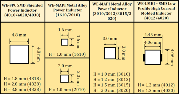

I started working on the Particle Counter Booster Pack schematic and PCB, and in the meantime I did a primer on using the surface mount equipment I ordered. I made it video based, showing how to remove components and how to reflow using solder paste. WURTH ELEKTRONIK was another sponsor in this competition, and provided some really great design kits for their product line of inductors. In fact, there were so many choices it required a decent amount of investigation to select the appropriate inductor. As such, I did a blog post on the selection of inductors and which I had chosen for my design. I was doing a mixed-signal design (analog and digital) so inductive isolation/coupling was necessary. I created the graphic below to aid in my selection, and I also talked about the different benefits of each inductor type.
WÜRTH ELEKTRONIK Inductor Selection (click to zoom)

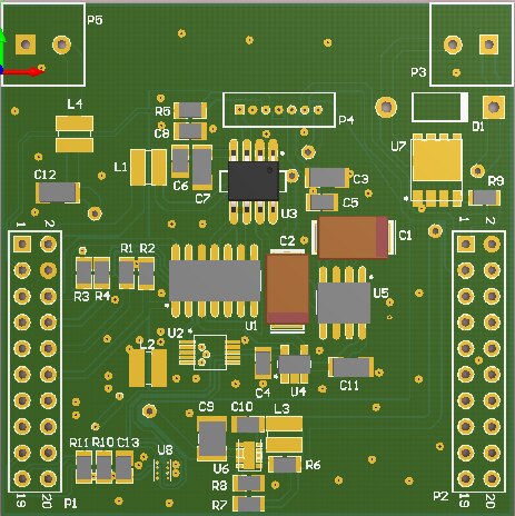

As part of the inductor post I also talked about using inductors on PCBs for such things as filtering, ground bridging, supply coupling, and buck regulators. At this point I completed my PCB design. and of course, I blogged about it. This post included text, pictures, and videos. I explained some basic PCB design guidelines and how to practically separate analog and digital portions of the circuit board. I've reproduced a 3D rendering of the board below:
3D Render of the Particle Counter Booster Pack PCB (click to zoom)

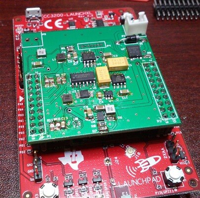

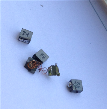

By this time it's about February 12, 2015. (almost two and a half months from when placed my orders). I populated the board and made a video about it, which was the topic of my 8th blog post. Populating went well, and while troubleshooting some initial problems I had a few inductors blow up (see below). The board was finally powered without any shorts occurring. And, before you ask, no, I do not own a current controlled power supply, but I guarantee it's the next thing on my list!
Inductor Graveyard and Modified Particle Counter Board (click to zoom)

To measure particle counts one needs to flow particles through a sensor. For flow control I opted for a PWM approach, and I blogged about that in my 9th blog post. I took a video of the PWM signal that drives the pump and showed an interrupt based approach to modifying the PWM duty cycle. I needed to make a board modification as well, so I made a video showing how to make a modification without ruining the board as part of that blog post. See above for a picture of the board mods.
I was moving at a decent pace once I had my board populated, but once I started programming the I²C devices on my board I found out my DAC7574 is dead. Well, it's outputs are dead. I'm not sure what happened to it, but it's definitely dead. The device acknowledges every command sequence I send it, but the outputs will just not turn on. The code comes from a known working library, and I've decoded the data on an oscilloscope. The next step will be to replace the chip, but I have to wait for those original samples to show up.
