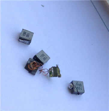

Board is complete, and not destroying components ... anymore. I went through 4 inductors troubleshooting this one. I really should get a current limited supply. Here's a picture of the inductor graveyard.
I also lost a buck regulator in the process. In fact, it was the buck regulator that originally caused the first inductor to be destroyed. There was a short from power to ground under the regulator, and that's how the first inductor got destroyed. Then, somehow, the power supply leads got reversed, and that took out another inductor. Finally, four inductors later, the board is working. These inductors are quite handy when prototyping; they act like a fuse of sorts.

    I selected one of the UART pins for use with dust sensor so I didn't have Serial debugging capability until I assigned a different pin by using the same method as you did image Since I plan to use the UART for communication with FRAM board later, I had to modify the board, it's not just for the sake of debugging.
    Do these inductors always blow so obviously like this or they can burn without showing visible marks? Hopefully my inductor is fine, I only had one (I didn't receive the kits), I will have to check it.
