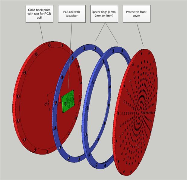

The image below shows a 3D mockup of the parts I'm planning to print. There are three types of circular plates, each with holes along the side to attach them together with nuts and bolts.
The back plate would basically be replaced by a solid plastic plate with a thickness of a few mm so it is rigid enough. In the back plate there is a slot to fit the PCB coil that came with the LDC1000EVM. This is just to test the basic functionality using that coil. I will probably have to design my own coil at some point to get the best results. In front of the back plate there will be a couple of plastic spacers to get the best possible distance between the coil and the diaphragm. I will print spacers of 1mm, 2mm and 4mm and experiment to find the optimal distance. The diaphragm should be mounted after these spacers, but I'm not yet sure what type of material I will use. Aluminum foil might be suitable for the diaphragm, but it is pretty fragile. I might consider using a type of conductive spray (made for EMC shielding, example: SCP03B - ELECTROLUBE - PAINT, CONDUCTIVE, SILVER, 3G | Farnell België) and spray that on some other type of flexible material (some type of plastic foil or sheet). This type of spray contains silver or nickel particles so it should be a very good conductor. The last plate is just a protective cover to improve the overall sturdiness of the assembly.
To get an idea of the size: each rings has a total diameter of 110mm. The spacers have a border of 5mm each. I will use 2.5mm bolts to keep it all together.

    The texts I've read mention that movement of a larger diaphragm should be easier to detect, but you are right that most condenser microphones have a much smaller diaphragm. A larger diaphragm seems to have a bad high frequency response. I haven't found any text that explains the actual diameter they typically use (12mm to about 27mm) though. As for the thickness of the diaphragm: they typically use a 3-6micron sheet of mylar which is then gold sputtered, but this is very hard to do manually. The LDC1000 is able to pick up the movement of the aluminum foil I've tested, but the coil has to very close to the foil. This is also the reason I'd like to use a very flat PCB coil like the one that came with the LDC1000EVM.
    e14 Contributor over 12 years ago in reply to e14 Contributor
    As I mentioned in my blog, I do intend to make a custom coil in the end. The thing is I think it would be best to use a PCB coil as they are very flat (the coil needs to be mounted very close to the diaphragm), but I don't have the means to manufacture a PCB coil with very thin traces. That's why I wanted to try it out with the coil that came with the EVM first before I have any PCBs made.

    What frequency range do you expect your microphone to work over ?
    It looks much too big for normal audio range.
    It's a while since I designed anymicrophones and I never designed any moving iron parts but this extarct from "Electroacoustics" , (written by ML Gayford and published by STC/Newnes Butterworths in 1970) may help.
    Notice how small the parts are, yet this was a large device by modern standards. The (big) problem with moving iron microphones is the mass of the iron. Your inductance sensor will be more sensitive with a larger mass to detect (although the target does not need to be ferromagnetic it must conduct well and very thin films won't be good enough - try copper foil.)
