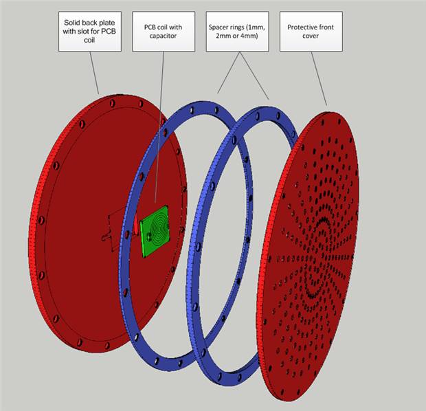

The image below shows a 3D mockup of the parts I'm planning to print. There are three types of circular plates, each with holes along the side to attach them together with nuts and bolts.
The back plate would basically be replaced by a solid plastic plate with a thickness of a few mm so it is rigid enough. In the back plate there is a slot to fit the PCB coil that came with the LDC1000EVM. This is just to test the basic functionality using that coil. I will probably have to design my own coil at some point to get the best results. In front of the back plate there will be a couple of plastic spacers to get the best possible distance between the coil and the diaphragm. I will print spacers of 1mm, 2mm and 4mm and experiment to find the optimal distance. The diaphragm should be mounted after these spacers, but I'm not yet sure what type of material I will use. Aluminum foil might be suitable for the diaphragm, but it is pretty fragile. I might consider using a type of conductive spray (made for EMC shielding, example: SCP03B - ELECTROLUBE - PAINT, CONDUCTIVE, SILVER, 3G | Farnell België) and spray that on some other type of flexible material (some type of plastic foil or sheet). This type of spray contains silver or nickel particles so it should be a very good conductor. The last plate is just a protective cover to improve the overall sturdiness of the assembly.
To get an idea of the size: each rings has a total diameter of 110mm. The spacers have a border of 5mm each. I will use 2.5mm bolts to keep it all together.

    Are you planning to use the standard PCB coil? Because I think a custom coil with more windings would we much better for this project.
    e14 Contributor over 12 years ago in reply to e14 Contributor
    As I mentioned in my blog, I do intend to make a custom coil in the end. The thing is I think it would be best to use a PCB coil as they are very flat (the coil needs to be mounted very close to the diaphragm), but I don't have the means to manufacture a PCB coil with very thin traces. That's why I wanted to try it out with the coil that came with the EVM first before I have any PCBs made.
