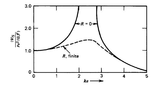

The next important parameter is the sensitivity of the microphone. This will be determined by the resolution of the LDC1000 and coil, but also by the displacement of the membrane.
To determine the displacement we have to make certain assumptions. First of all the displacement will, over a large frequency range, depend on the frequency and the amplitude of the applied pressure wave. Second, we can determine either the displacement in the center, or probably more important in our case, the average displacement over the entire membrane.
Displacement of the membrane at distance image from the center is:
The average displacement amplitude over the entire surface area of the membrane is found by averaging the first expression over the surface area:
Using the same values as before, we have:
The Bessel functions are:
The average displacement then becomes:

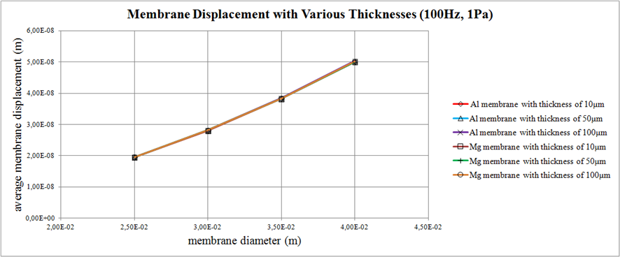

The next figure shows the influence of the membrane diameter, thickness and material on the average displacement.
The average displacement increases significantly with the diameter and thickness of the membrane, however increasing these parameters will decrease the fundamental frequency. The type of material also has an effect on the displacement: a lighter membrane decreases the average displacement. EDIT: the first figure shows membrane displacement at a frequency of 1000Hz, which is close to the resonance frequency. The following figure shows the effect of resonance (remember: ka=2.405) on the
imageThe next figure shows the displacement at 100Hz, much lower than the resonance frequency:
This figure shows that the displacement is nearly independent of membrane thickness. I will have to verify if this is actually correct, because it seem counter intuitive at first sight (try putting a piece of paper in front of a speaker and then try the same with a sheet of plastic). It might be because the stifness of the membrane is so small compared to the applied tension that it does not have a significant effect (as compared to vibrating bars or plates), but as I said I will need to double check this.image
