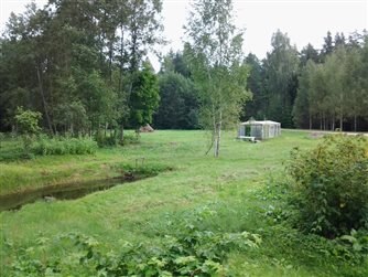

16 Aug. Solar-driven energy-harvesting water pump
In the weekend I have set up a solar-driven 12V water pump to bring water from the pond to a container at the greenhouse.
To be able to run the pump in cloudy days I use energy harvesting in a 1F supercapacitor. Technical details I have summarized previously
Energy Harvesting for Solar-driven Water Pump
During sunny conditions it pumps 10 liter bucket full in 4 minutes. (2 l/min = 120 l/h). Useable pumping height is up to 2 m.

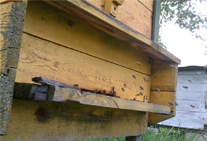

19 Aug. Beehive
Today I am visiting my uncle who is a beekeeper. I told him about IoT possibility to measure beehive temperature, humidity and weight.
He told that major unsolved problem would be to predict bee swarming. In hot days about a half of bees from strong colonies leave their hive with the new queen.
It is a large loss for the beekeeper. In hot days is necessary for someone to sit there and observe bee activity.
May be I could make a bee counter exiting the hive using LED+photodetector like in robotics or TV remote control. Increased bee number from one hive could probably be an indication of swarming. For a test I placed an Android phone in front of hive exit. May be one could think of and algorythm for bee counting using image processing. Activity changes considerably, for example, when it started to rain, it a lot of bees were suddenly returning home within a few minutes.

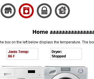

25. Aug Out Of the Box Example
As logical next step was to try to debug Out of the Box example OOB. It worked.
I could not find where is html code of the example. It appeared that it is put in a html directory under example directory.
I edited html code. Rebuilt project, and started to debug. Http pages had not changed.
It appeared that need to install and use Uniflash to flash html code to a flash chip. CC3200 stores webpage code in a flash chip.
Now modified example changed appearance.
I am now trying to understand how data are passed to the html code and back.

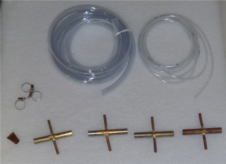

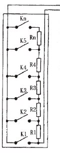

Preparing parts for the watering system

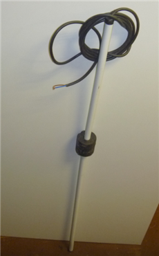

For Water height measurement in a 200l barrel I have made a special stick. Inside a sealed plastic water pipe tubing is a resitor divider made of 10k resistors separated by 5 cm. Resistor chain is shorted to GND using reed relays activated by a floating magnet.
Optical and capacitive methods would not be good as water gets algea growing in it and covering all surfaces.
Sparkfun eTape liquid level sensor would be good to use but I learned too late about it.
I have prepared water distribution pipes to each tomato plant and plan to deploy the system during next vegetation season.
