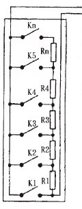

For Water height measurement in a 200l barrel I have made a special stick. Inside a sealed plastic water pipe tubing is a resitor divider made of 10k resistors separated by 5 cm. Resistor chain is shorted to GND using reed relays activated by a floating magnet.
Optical and capacitive methods would not be good as water gets algea growing in it and covering all surfaces.
Sparkfun eTape liquid level sensor would be good to use but I learned too late about it.
