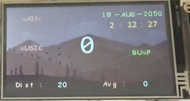

Ok, In this Blog I will talk about implementation of the Sensor Subsystem in My project.
Firstly the Role of Sensor Subsystem was to identify the weather for ride and to send it to the User. I had Dropped the Idea of pothole detection as it was not a worth Idea, moreover In my Nextion display You could just touch to report the pothole. see the BUMP Button below !!
As there was a mBed Library available online HERE as well as an Example Program available HERE it was easy to get started with the Library and implement the rest.
Now I would like to post my Implementation code snippet
