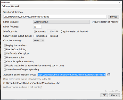

Programming the Nucleo STM32L476
I have found it a bit confusing programming the Nucleo in the IDE's suggested from the site. I am use to the Arduino IDE as it is fairly easy to use. So, I found a way to program the Nucleo with the Arduino IDE. This was created by Srihari Koripalli who deserves all the credit for this.
Below is how it is done:
  • Open the Arduino IDE
  • Go to the "File" menu
  • Go to "Preferences"
  • Under "Additional Boards Manager URLs" enter the link below:
https://raw.githubusercontent.com/stm32duino/BoardManagerFiles/master/STM32/package_stm_index.json
  • Go to "Tools" menu, Click on "Board" then Click on "Boards Manager"
  • Scroll down until you find the "STM32 Core" Package by ST-Microelectronics and install it. This will take a bit of time to install.
That is it for this part
