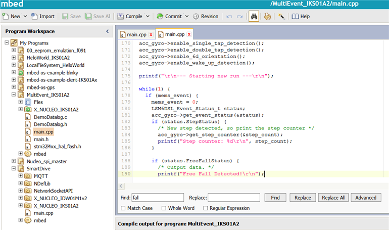

There are several type of events I'd like to detect from the MCU and its sensors in my project One of them is Fall Detected event I was very happy to discover that mbed has MultiEventIKS01A2 demo application It demonstrates capabilities of different  X-NUCLEO-IKS01A2X-NUCLEO-IKS01A2 sensors including Free Fall Detection
I've compiled it and was able to run successfully on my board.

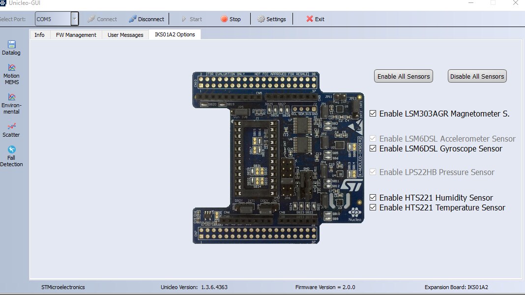

The documentation for X-CUBE-MEMS1 describes use of Unicleo-GUI to visualize in real-time data captured from the board/sensors. I've compiled and loaded Fall Detection application form  X-CUBE-MEMS1 to the board. Unicleo-GUI was able to recognize my board.

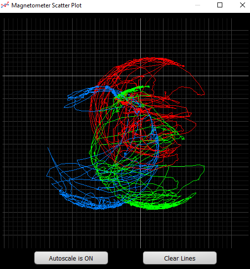

It provides different visualization tools for different sensor types. The following one was for magnetometer:

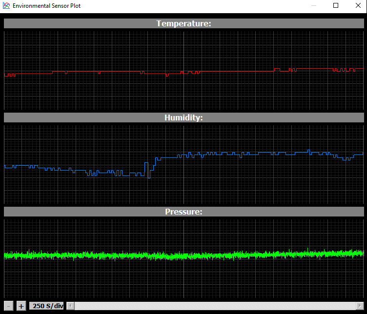

There is one for environment:
I was a bit surprised by humidity sensor as it fluctuated a lot without any changes in the environment other then my attempts to emulate falls..

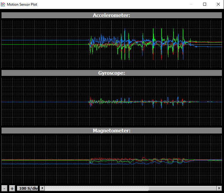

There is another visualization tool for motion sensors:

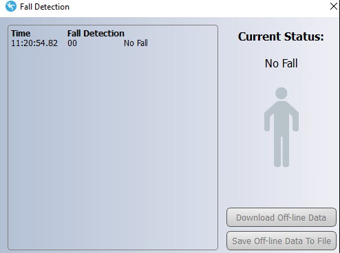

You can see there some large green spikes at times when I was trying to test falls. Unicleo-GUI has as well a GUI for fall detection:
But for some reason it hasn't detected falls compare to mbed sample, which was able to detect them quite reliably.

    Does anyone have any insight as to what the magnetometer is showing with the 3 colored spheres, It looks great but I have no idea what I am looking at haha

    This is a description of the magnetometer visualization from UM2128 http://www.st.com/content/ccc/resource/technical/document/user_manual/group0/b9/d0/7c/c5/a8/55/4c/bc/DM00337036/files/DM00337036.pdf…

    just to add, .... when you start to rotate with the board hosting magnetometer in the 3D space - in all possible directions - and you capture the magnetometer raw data at the same time, as a result, you will get the Earth magnetic field exposed to all 3 magnetometer axis with a different strength depending on the actual orientation of the sensor vs. the Earth magnetic field. In 2D plots you can see this as filled circles. Interesting is to notice, that the 2D filled circles are shifted from the center of the coordinates, which means there is an offset in the measurement. For practical use of the magnetometer, it is needed to calibrate the sensor on offset.

    This is a description of the magnetometer visualization from UM2128 http://www.st.com/content/ccc/resource/technical/document/user_manual/group0/b9/d0/7c/c5/a8/55/4c/bc/DM00337036/files/DM00337036.pdf/jcr:content/translations/en.DM00337036.pdf :
    • the red line represents the magnetometer X data on the X-axis, and the magnetometer Y-data on the Y-axis;
    • the green line represents the magnetometer X data on the X-axis, and the magnetometer Z-data on the Y-axis;
    • the blue line represents the magnetometer Y data on the X-axis, and the magnetometer Z-data on the Y-axis.
