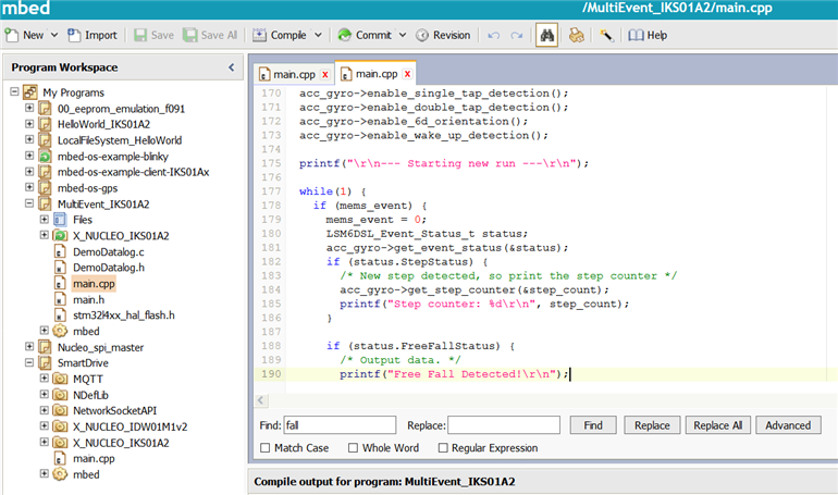

There are several type of events I'd like to detect from the MCU and its sensors in my project One of them is Fall Detected event I was very happy to discover that mbed has MultiEventIKS01A2 demo application It demonstrates capabilities of different  X-NUCLEO-IKS01A2X-NUCLEO-IKS01A2 sensors including Free Fall Detection
I've compiled it and was able to run successfully on my board.
