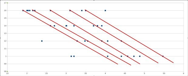

Here is a scatter plot of resonant frequencies on the X axis versus air volume on the Y axis:
imageThere doesn't seem to be much vertical alignment (indicating resonances that do not change with volume)
Below I assume the frequency increases linearly as the air volume decreases and draw some straight lines through possibly related resonances:
It doesn't make sense to me that all the frequencies would increase with decreasing volume, but maybe it is possible.
Next I tried to add water slowly and track the resonant frequency of a single initial resonance to see if these straight lines represent what is really going on.
This was a bit harder than I anticipated. It seems like a resonance dies off as volume changes by about 30 ml and a new resonance mode starts up at a different frequency. This may mean most of these resonances are not the air cavity, but the varying mass relationships can allow whatever is vibrating to resonate or it can damp them out. So I will need to investigate every resonance to see if it actually tracks the air volume ..... oh joy. At least this cool oscilloscope allows me to investigate without rebuilding a bunch of circuitry. I was hoping that the lowest resonance would be the Helmholtz resonance, but so far the data doesn't support this theory. (The Helmholtz resonance is the lowest resonance of the air in a cavity) Some people do a whole 2 year thesis on stuff like this - I need results faster than that.
One thing I didn't plot above is the amplitude of the resonant frequencies, but it seems to have some correlation with volume - the more water the higher the signal amplitude.
The investigation continues....
