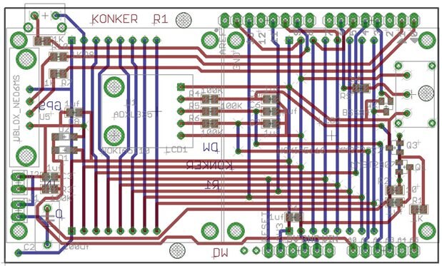

Up next I had to tackle the issue with designing an interface card to implement the features of my design. The expansion cards in the challenge kit were really not playing well with each other or the functionality I wanted to implement, there were heavy pin conflicts with multiple cards vying for use of the same pins. I have not completely decided what is the best way to resolve the radio conflicts as those cards use a lot of pins. However I did press on and designed an interface card that handles all the other functions, so I don't need to struggle with card conflicts.
This custom expansion card handles:
  • 2 graphical LCDs
  • a 3-axis accelerometer
  • driver crcuitry for the gas tank exciter
  • signal conditioning for the gas tank sensor
  • a GPS
  • a couple of mode switches
  • and some power distribution
The card has significant protection on a lot of pins, partly because of all the potential pin conflicts and partly because the arduino uno connectors supported by the Nucleo MCU are expecting 3.3 volt signals on this platform, but the uno and many shields for the uno work off 5 volts, which is available on the connector.
Here is a picture of the PCB layout as it stands today:
I have all the parts on order I think, but some have long lead times, so this is going to compress the schedule down the road.

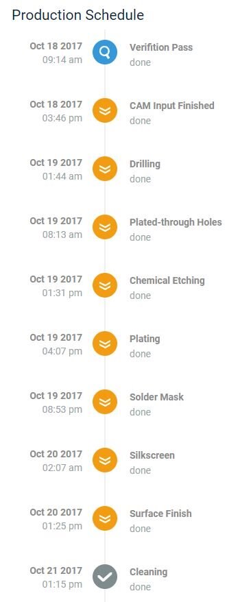

ITEAD makes it easy to follow the PCB build process on their web site - this shows the card is almost done...

    Nice update. I had a wild thought. I wonder if the normal operating RPM of the engine is going to influence your resonance ability on the motorcycle? Even at high RPM, there is a lot of low frequency vibrations…
    mcb1 over 9 years ago +1
    I was wondering if you were to calibrate it using set amounts of fuel to get 1/8, 1/4, 1/3, 2/3 (or the litres). Perhaps you start with an empty tank and add a known amount and measure the frequency then…
    dougw over 9 years ago in reply to mcb1 +1
    It is old school carburetor. I would be happy with a crude fractional measurement for this application - as you suggest. Note that the scope has a high sensitivity - those resonances are only 3mV peak…

    dougw over 9 years ago in reply to DAB
    I'm sure you are right. I expect if it works at all that it will only work well when the motor is off - which is still useful to me.
