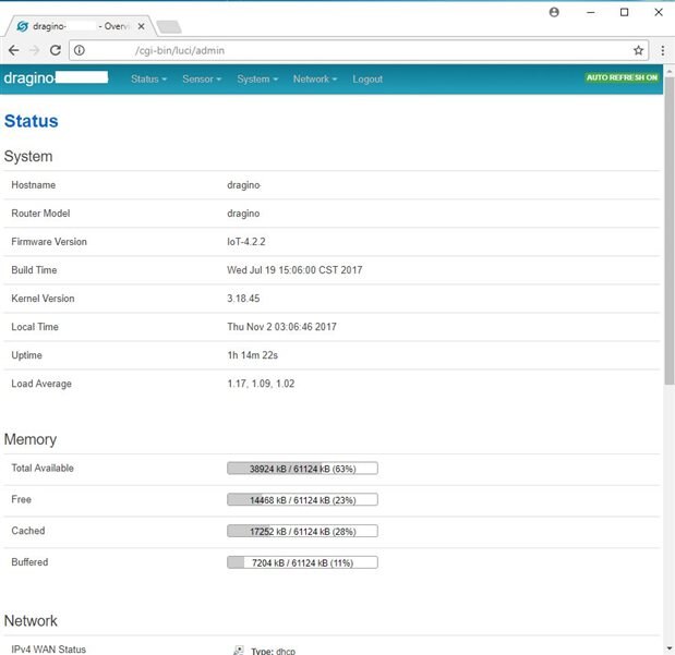

Baby steps.... I've been lost in "a maze of twisty little passages" at the end of a long rat hole ... trying to set up my back-end infrastructure to  where my LoRa gateway sends GPS data across the internet to get plotted on a map accessible from any browser.

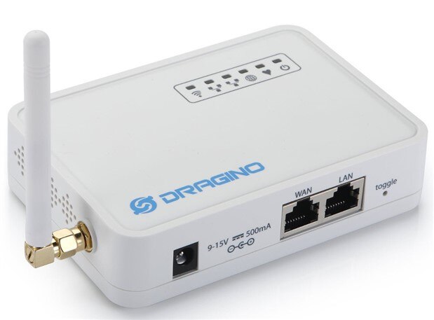

I am using a Dragino LoRa gateway which is now (after many false starts and much head scratching) setup with a WAN ethernet connection to my internet router.
In addition to its LoRa gateway role it is also acting as a Wi-Fi hotspot. It has a web server to allow setup:

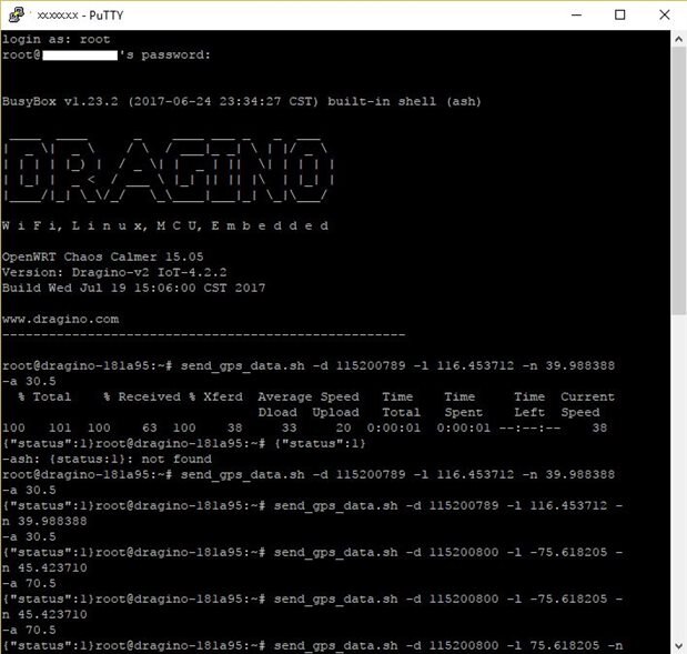

And I can use SSH over WiFi to force it to perform tasks like sending GPS data.
For a while there, I thought I had bricked the device - it wasn't communicating at all. This wasn't really the fault of the hardware, just my ignorance on several levels.

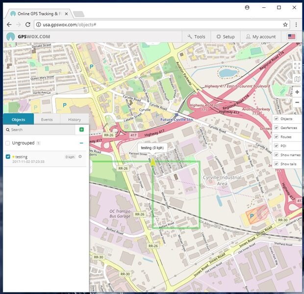

I still have not got the right code compiling on either the client or the gateway, but I can tell the gateway to send GPS data to GPSWOX and have it plotted on a map.... baby steps...
This map is a screen capture of my browser showing a (green) track of several locations I had the gateway send to GPSWOX that describe a rectangle in my city.

    mcb1 over 9 years ago +2
    Glad it was test data, otherwise your riding skills need some work
    dougw over 9 years ago in reply to mcb1 +2
    It is an off-road bike ... (or the track can be achieved by changing one digit in each set of GPS coordinates). I'm curious to see what real data looks like on a map,
