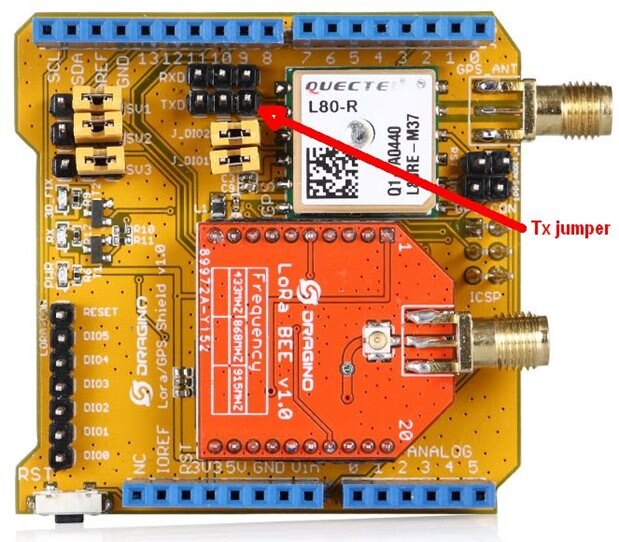

Eventually I chopped out the LoRa code and just tried to get the GPS working. After much tweaking I finally got the compiler to stop complaining and actually had a clean compile. However there was no GPS data being detected, so I checked it out with a scope and the GPS data was definitely sending good data every second as it was supposed to do. My scope can decode GPS messages and they were definitely solid.

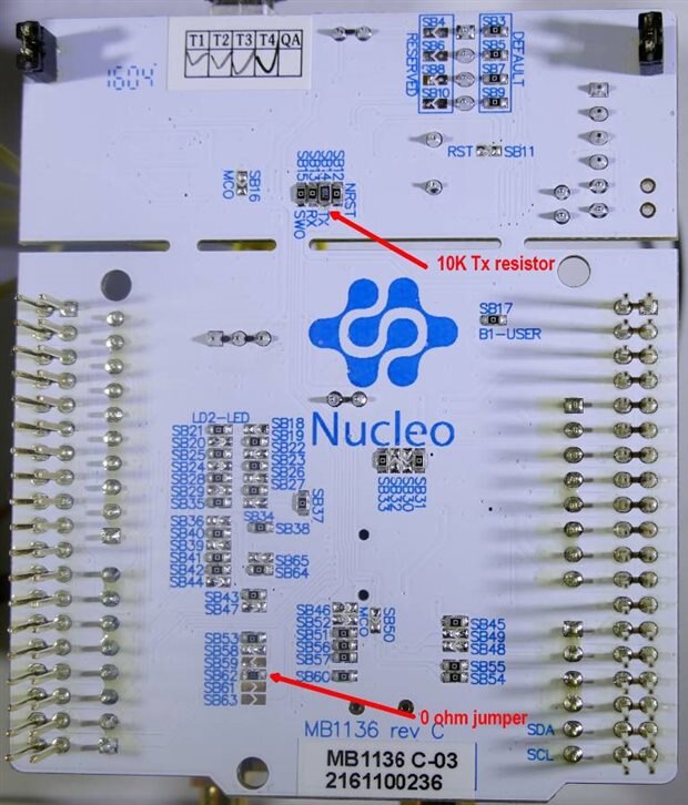

I then discovered that the standard serial pins on the Nucleo's arduino connector were not connected to the MCU. This info is documented in the Nucleo user manual, but of course I had made an erroneous assumption that the arduino pins were all connected. It turns out this port is used to program the MCU and is connected to the programming co-processor which uses the USB port. When I first discovered this I thought maybe it was like an arduino leonardo (which also has an on-chip USB port designated as the Serial port) where the standard serial pins could be accessed using Serial1 instead of Serial, but that is not the case.
There are 2 zero ohm jumpers connecting the Tx and Rx of the co-processor to the MCU which can be removed, and 2 sets of open jumper pads to connect the arduino Tx and Rx pins to the MCU, but if all these jumpers are configured for arduino serial communications, the ability to program the MCU is defeated.
Since the GPS is simply blasting out a data burst once per second, I only need the transmit pin connected. I removed the zero ohm jumper from the programming transmitter and replaced it with a 10K resistor. This way I don't need to re-solder the jumper every time I want to reprogram the MCU – I simply remove a jumper on the GPS transmit pin. Even if both transmitters are active and connected at the same time they see no more stress than a 10K resistor load. In ths scenario the GPS will control the pin and not be influenced by the programmer.
This arrangement was extremely important because I am going through an enormous number of reprogramming cycles and re-soldering jumpers every time is out of the question.

    I understand how much pain you would have undergone when things do not work the way we expect. Because I too had a similar situation, where I need to make the Bluetooth module communicate serially. The test went 100% Ok with Arduino UNO but in Nucleo-L476RG board, it failed. I have shared it on my blog Traffic Predictor #11 - Module 2 and 3 [Completed] under Hurdle.
    After a day's time, I was able to figure out where the problem was. I had to make D0 and D1 pins in the Nucleo-L476RG board to communicate serially whereas I came to know it was a known limitation [Link]. I had to then use CN3 RX and TX as per their suggestion instead of the soldering stuff [Link].
