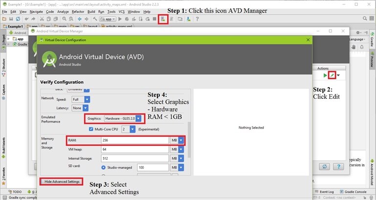

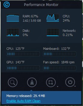

     The main limitation I felt using Android Studio is, it uses most of the computer's RAM (Full capacity of the computer - 4GB). This results in freezing/ hanging off my computer due to 90+% RAM usage. This is severely impacting the application development process as and when I need to test the code I have to wait for 10 to 20 minutes to visualize the output in the Virtual Device Emulator. Credits to IObit's performance monitor which saved my computer from most of the hanging part with an option "Clean RAM" [Refer below screenshot - Broomstick icon].
     One more option which I tried out was to reduce the RAM allotted to the AVD from and select Graphics to be Hardware. Refer below screenshot for steps which are given inside the screenshot.
If you have suggestions to make Android Studio work fluently without hanging while emulating the output, please do share in the comments section below.

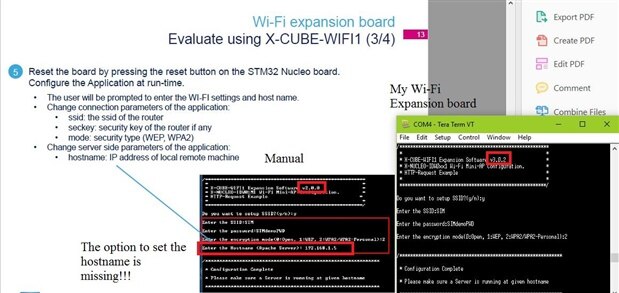

  • Wi-Fi Expansion Board - The Wi-Fi Expansion board X-NUCLEO-IDW01M1 comes with a handy instruction manual from the ST (Download it here). As per the manual, I set up the apache server on my PC and managed it through XAMPP. But I was not able to receive messages as instructed in the manual [Refer Screenshot below]. This can be due to the version difference, version from when they had prepared the document to the version available currently. This led me to a state where I am unable to ensure Wi-Fi expansion board setup is complete. Otherwise, things are good to go.
