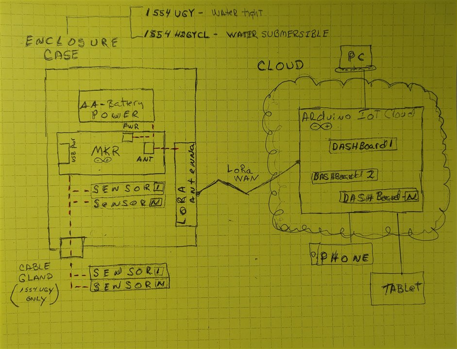

Basic Diagram for all TEST (1st try)
  • The following  Basic Design will be used for all enclosure test.
  • all test will include:
    • An Enclosure case either:
      • 1554UGY  IP66 Water Resistant
      • 1554H2GYCL IP68 Watertight Water submergible
    • An MKR WAN 1300
      • A basic sketch that will connect to the IoT Cloud Dashboard
    • A 2 AA Battery Holder attached to the MKR WAN 1300 connector
    • A connection to the Arduino IoT Cloud over the LoRaWAN
      • An LoRa Antenna attached to the MKR WAN 1300
  • Each test will contain
    • Sensor(s) attached to the MKR WAN 1300
    • A minimum of 1 sensor will be attached per test. (For example a temperature sensor to measure the enclosures internal Temperature )
    • Sketch code added to the basic sketch mentioned above.to READ values from the attached sensors.
    • An Arduino IoT Dashboard to display the sensor(s) values.

Basic Diagram for all TEST (New Solution)
  •  My original design in the first try, could not connect to the Arduino IoT Cloud directly over LoRaWAN because of my location to a Pro Gateway in the Things network
    • I needed to design an additional piece in, that would allow the two MKR WAN1300's to talk together over LoRaWAN and one MKR WAN 1300 would connect to a Nano WIFI IoT board over a TX/RX serial connection.
    • Then the Nano would talk to the IoT cloud over my home WIFI router.
  • The next Section describes my New Solution.
