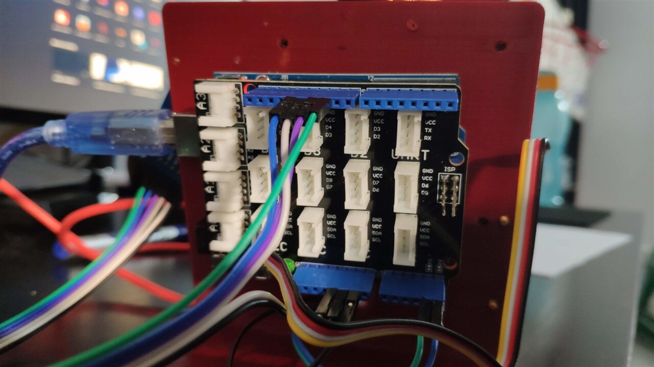

On this post I will discuss the role of the Arduino UNO. This one is the one that displays the data measured and saves it to an SD Card.
This Arduino receives the values from I2C, sent from the local MKR 1300 WAN .
The data received is a string. It then splits the string into various components and displays them.
Here's the schematics
You can see that the Grove base shield is on top of the Arduino UNO, but the pins remain the same.
