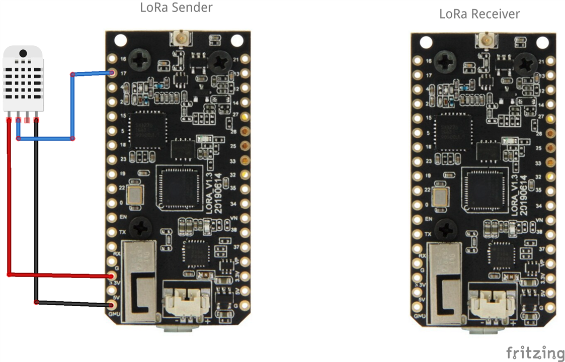

While the kit does not arrive and having two TTGO LoRa ESP32 SX1267 modules, I've decided to start learning how to send data from one module to the other. And, since temperature is one of the components to monitor in my project, let's use a DHT22, read the temperature and humidity and send it to another module.
Hardware
  • 2x LoRa ESP32 SX1276
  • DHT22 (or AM2302)
Here's the schematics

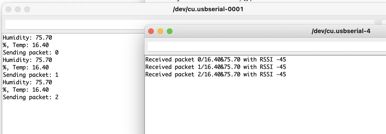

Here's the result, with the two modules connected (different serial ports), sending the temperature/humidity and receiving it in the other module.

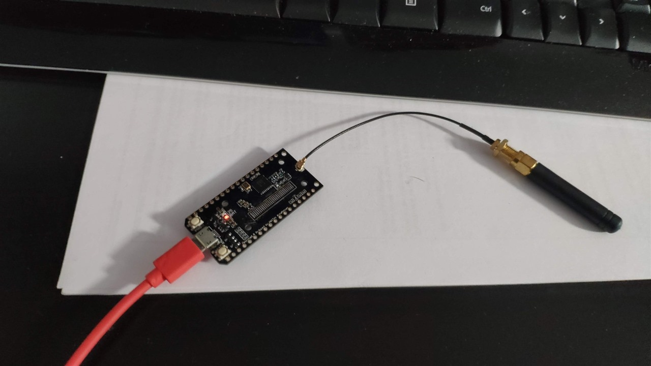

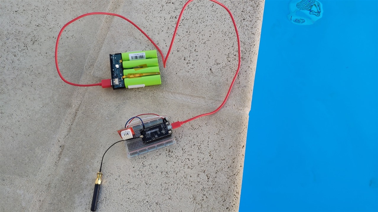

Since both were communicating, it was time to do a live testing, getting values from outside.
I've placed the module with the temperature sensor outside, powered by a power bank and the other module connected to the computer

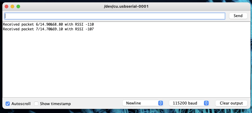

After powering both, the results started to appear.
