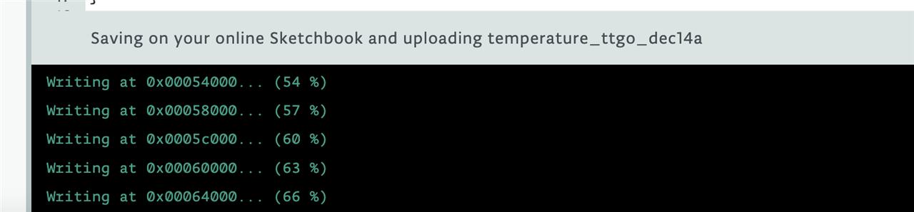

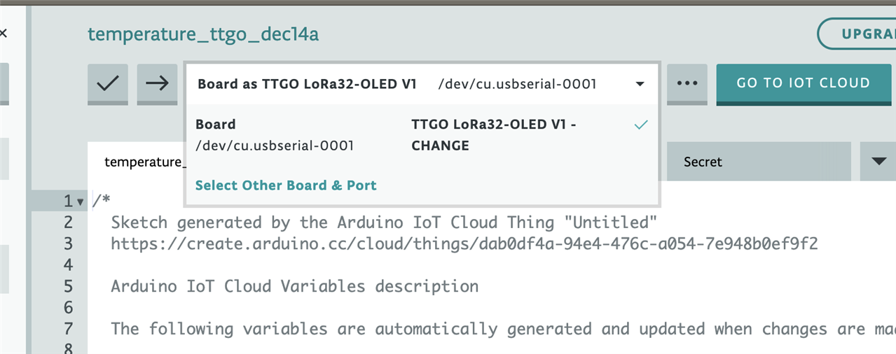

My device didn't get recognized by Cloud sketcher, but, using the full editor, the device is recognized and I'm able to upload the sketch to the device.
After there it is, uploading..

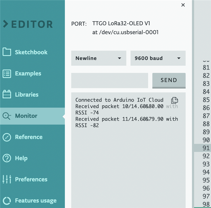

Now, in the serial console tab, receiving the temperature from the other module - the one with the DHT22

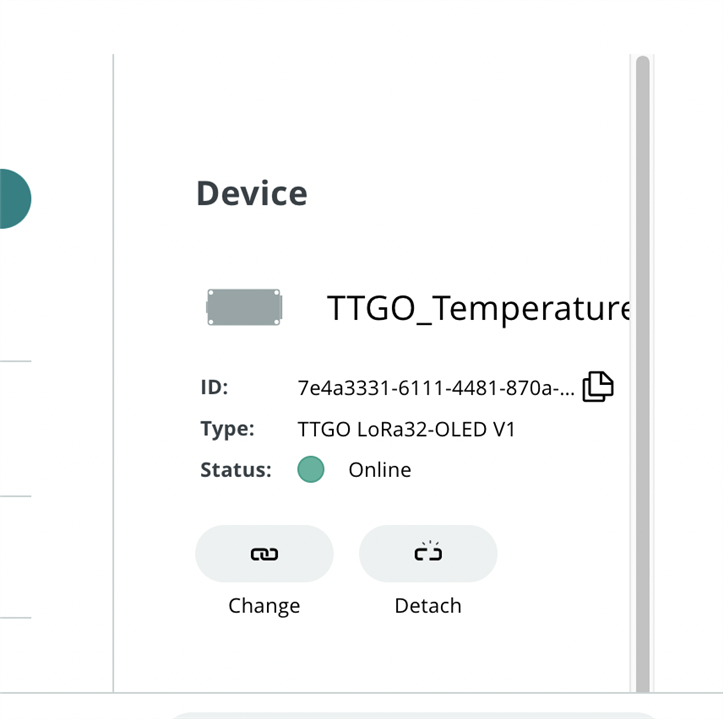

Here's the device online - but not recognized by IoT Cloud.. Strange...

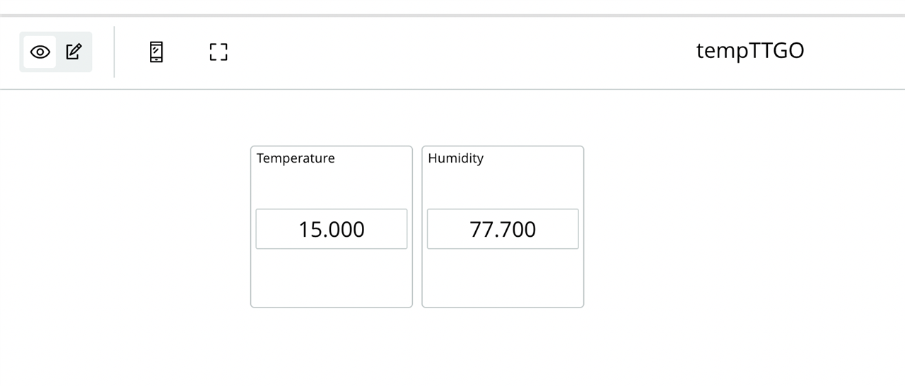

After this, I created a dashboard and displayed the variables in it.
And here it is, Lora to Lora to Arduino IoT Cloud using two TTGO ESP32 SX1276.
