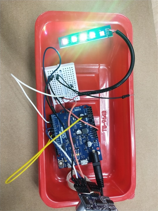

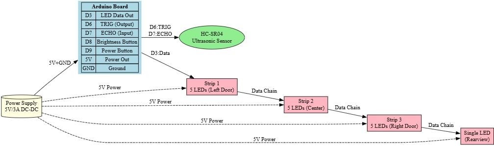

2.2 Hardware Connection

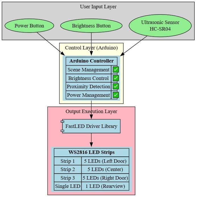

3. System Architecture Design
3.1 System Block Diagram
3.2 Software Architecture

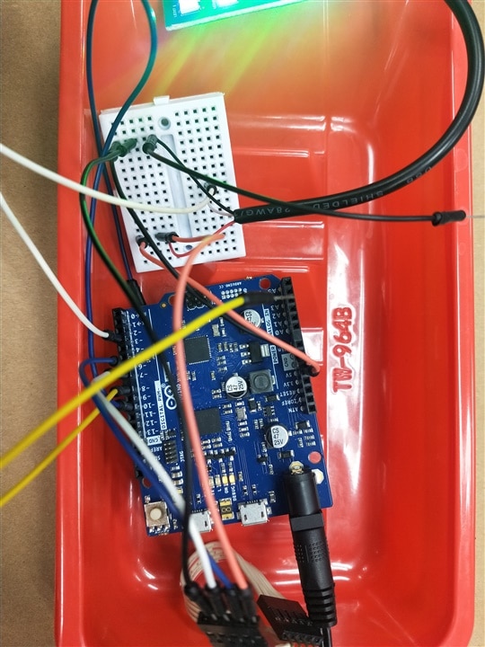

6. Project Photos and Final Effects
