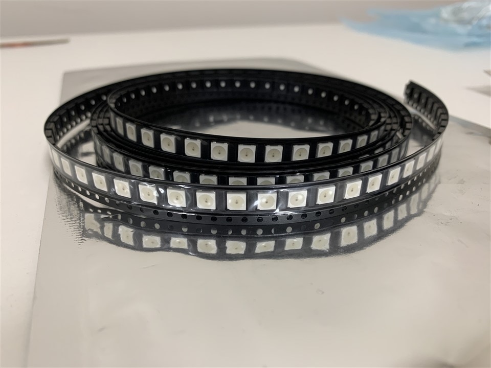

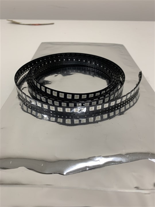

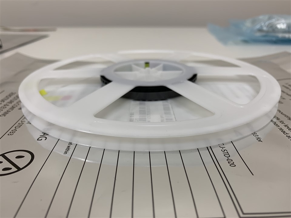

{gallery}The LEDs!
: This is how the LEDs arrived - in reels like this - here at our office.
: We will be dividing up the reels between all the Challengers. However, for convenience we will not be separating each LED individually.
: Hope this made for a fun little insight into the behind-the-scenes of Design Challenges.

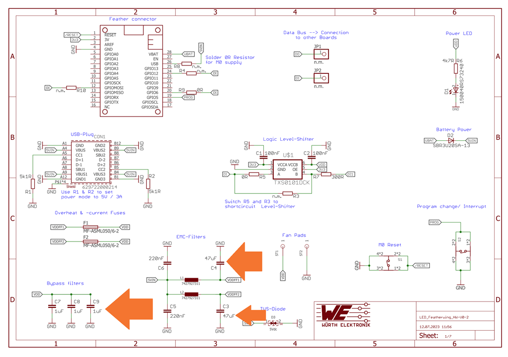

The design challenge’s kit also includes an Arduino Zero (ABX00003). Würth Elektronik shared with me these design schematics for the Featherwing which I have uploaded to the Files section of this Design Challenge to help provide an initial technical insight into how the LEDs can be used.

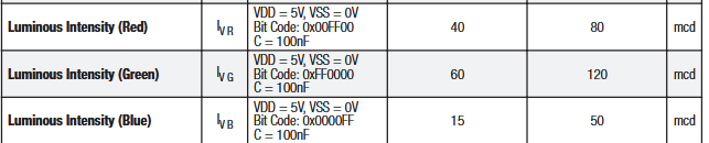

  • JWx
    JWx over 1 year ago in reply to Anthocyanina +2
    I think it was meant to be mcd:

  • embeddedguy
    embeddedguy over 1 year ago
    Is there any specific document for circuit design using this LEDs from Wurth? Like things to consider and best practices etc?

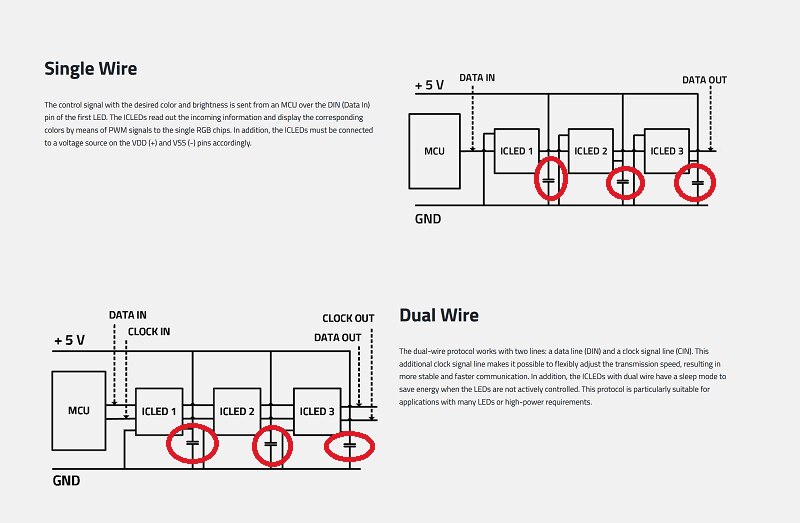

    misaz over 1 year ago in reply to embeddedguy
    Look at their webpage. There are datasheet, brief explanations, link to application note and most notably, recording of webinar, which explains lot of things including some best practices.
    https://www.we-online.com/en/components/products/WL-ICLED
  • embeddedguy
    embeddedguy over 1 year ago in reply to misaz
    Hi,
    So, I looked at basic schematic from the above and found that there was no capacitor on one of the schematics using LEDs.?
    And also, I saw some documents and one webinar on the link you have posted, there was not much on PCB or circuit design best practices.
  • arvindsa
    arvindsa over 1 year ago in reply to embeddedguy
    decoupling caps? you should definitely put it. 100nf near each LED and may me 10uF around start of each strip. if the LED color isnt gonna drastically change (gently fade from zero) you can get away without individual caps for each LED.
  • misaz
    I do not know what schematics you refer to. Even simplified schematics on directly linked page shows capacitors.
    I did not watch full webinar, but If there are not any concrete PCB layout requirements, follow standard one (ground plane under LEDs, wide VCC trace because high currents flow through it, etc).
  • embeddedguy
    Ok. look on the first schematic. BTW this is not serious because, I always follow the standard rules as much as I can. So, I know the above rules. Nevertheless, if there is any specific parameter in that case such guides can help us. That's why.

  • misaz
    Ahh, now I understand what schematics you mean. On this schematics, following caps serves the purpose:
    It works because featherwing is pretty small board and LEDs are still near the caps. But if you do something longer, I would recommend staying at old good 100nF near each chip (LED).
