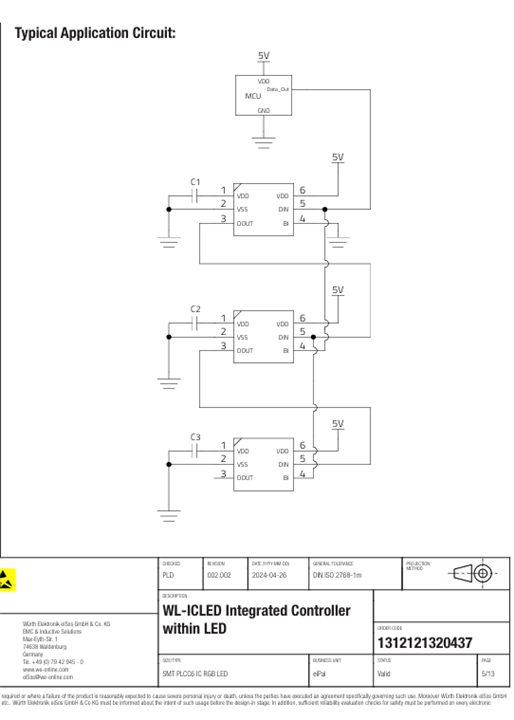

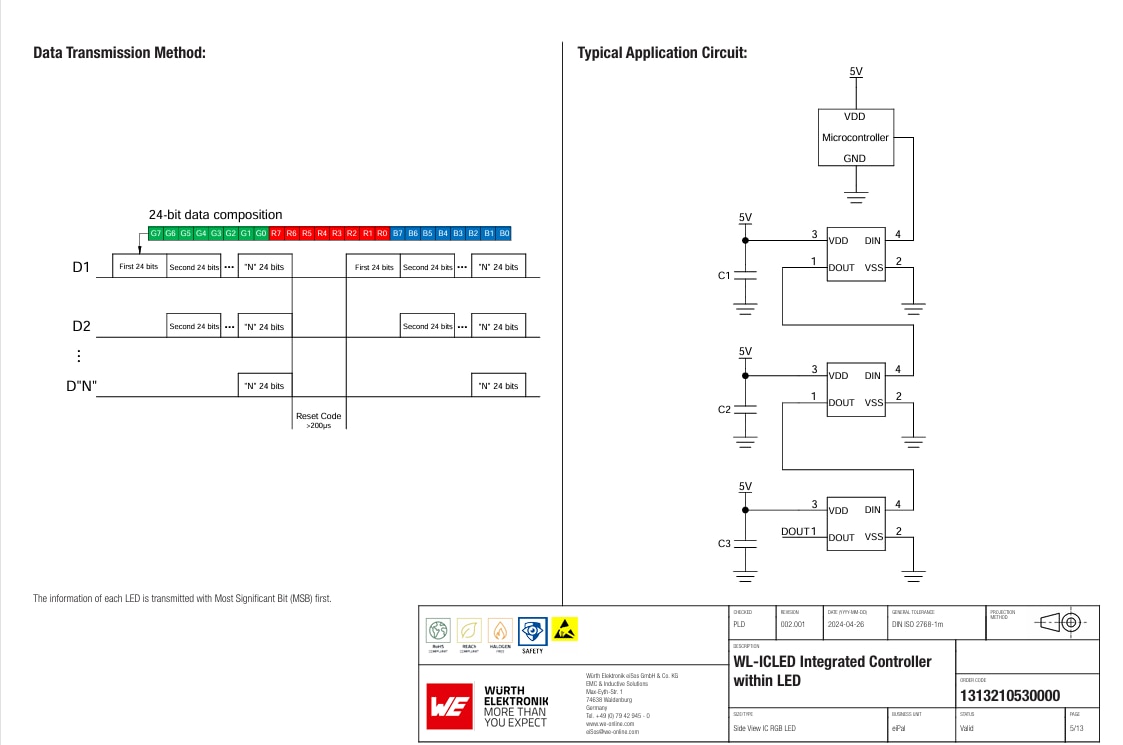

The color of each LED is represented with 8-bit value for each R-G-B channel. Hence, a total of 2^24 colors can be represented. The following image from one of the LEDs datasheets demonstrates how these LEDs can be connected in series and the data format to generate required color value. The first LEDs DOUT is connected to the next ones DIN pin. This way the internal chip of the first LED can transfer the next bytes of incoming color values to the next LEDs in series in the daisy chain method.
As soon as there is a RESET signal, the next incoming data for color values from the microcontroller will start from the first LED in the series.

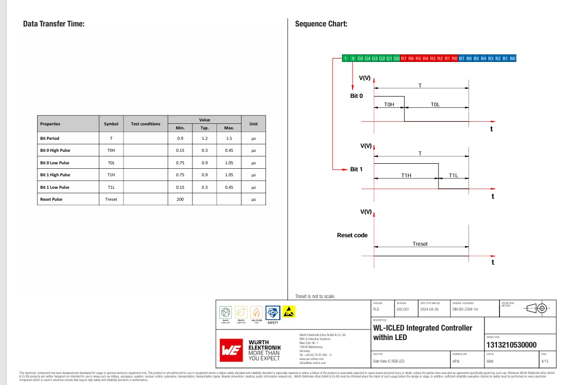

The timings of these LEDs are also important to understand. The following figure explains it visually. The code 0 and code 1 is represented with different kinds of PWM signals. The total wavelength remains the same that is approx. 1.2 us. But the duty cycle changes if the code is 0 or it is 1. For the reset signal though, the period is approx. 200 us.

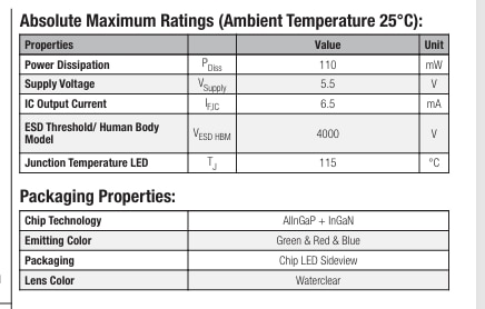

Würth Elektronik provides this power ratings into their datasheet. The following image from one of the datasheets of their LEDs is an example tobe considered. These are the absolute maximum ratings for the LED. To calculate the maximum current that a number of LEDs will require we can use the following table.
As per the table, each of this LED requires 6.5 mA to operate. Technically, as there are three LEDs in one we need to calculate the current accordingly.
So, if I am using three LEDs of this kind, it will require approximately 60 mA to operate. This will help me to decide weather a perticular GPIO is able to handle this current or not.
6.5 x 3 x 3 = 59 mA.
Each one of these LEDs needs decoupling capacitor that is required to filter the incoming power supply ripples. Normally and for most LEDs from Würth would need 100nF capacitor of X7R gradient rating.

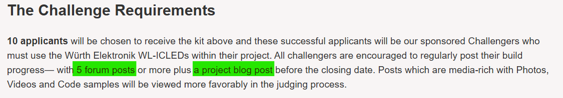

    Hi, your blog post has been converted to a forum post, here's a reminder of the requirements:
    " All challengers are encouraged to regularly post their build progress— with 5 forum posts or more plus a project blog post before the closing date. Posts which are media-rich with Photos, Videos and Code samples will be viewed more favorably in the judging process."
    The project blog post is meant to be your final write up Slight smile

    embeddedguy said:
    I use the following page to create a Blog post. Isn't that correct?
    No, not until your project is complete, please re-read the following (and the terms and conditions):
    "All challengers are encouraged to regularly post their build progress— with 5 forum posts"
