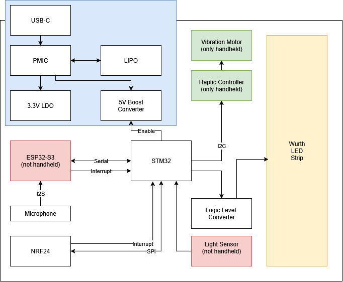

Designing three different devices with minimum resources was a little bit challenging but I came across a way to make it happen. Let's start with the different Function I need (irrespective of the device)
Functionality
1. Power:
All three devices require a LiPo battery which can be charged by USB-C. For the hand held device, LiPo is the primary source and is subject to regular charge and discharge cycle whereas in the wall mounted device, it is optional as a backup, but can be used as primary. Therefore the requirement of a Charger. A power path management IC, Voltage regulator for 3.3V. Now, when the devices are being powered by the battery, we need to provide 5V to the LED. I initially thought, why not output the LiPO voltage directly to the LED and Voltage level converter? It had worked for me in WS2812B projects in the past. But i decided to go against it because for me i need maximum LED brightness when needed, and so rated typical voltage is the way to go.
2. CPU:
 I am a big fan of STM32 and so will be going ahead with that. Reasons apart from my experience and comfort level is that for the handheld device i want to reduce the power consumption as low as possible and so STM32L031 Chip is what i will go with and for other devices, STM32F103C8T6, the infamous Blue pill chip. Chip.. not the development board. There are better options in STM32 Family but both L031 and F103 are chosen because of a healthy balance of low cost, easy availability and has plenty of support in the stm32duino community. I would have loved to go with NRF5 series due to their super low power consumption, and have been itching to do it for this project but sadly, another project which i am working on got delayed and so, i wont have enough time to experiment with the NRF
3. Co-Processor:
ESP32-S3. Cheap, Edge Impulse supported and easy to implement, the downside being the  power draw. But since I will be there only in the wall mounted device and is expected to always be connected to mains, I am not gonna worry about the power draw. It is an AI based project anyway
4. Communication:
 NRF24L0 Module is what I will be using to create a mesh network inside the home to carry the alert signals. The Interrupt option allows me to wake up the primary CPU while it's sleeping thus reducing the power consumption of the hand held device as low as possible. Again, I wanted to use the NRF5 series, as it can also use Enhanced Shock Burst protocol to communicate with each other by wireless transmission. It would have replaced both stm32 and the nrf24 together. But a working prototype in time is priority
5. Microphone:
The INMP441 is ideal for this project because it’s a low-noise, digital I²S microphone that connects directly to the ESP32-S3 without extra ADC circuitry, giving you clear audio capture for reliable sound detection with minimal hardware effort. I hate using ADC for audio applications, as they add noise, complexity, and calibration hassles compared to the clean digital stream from I2S.
6. Others:
I need a Light sensor to adjust the Brightness of the LED automatically, but have not started any research on it. In fact, this will be the first time I am gonna be using a light sensor in any of my projects. The last time I used it was during my college lab 10 years ago. Gotta see what's new there. For the hand held device, I will be using a powerful vibration motor. I got 3 with me. The big one wins my heart. It will be driven by DRV2605L from TI. It makes it very easy to generate a wide range of vibration patterns, and I can also pair different sounds detected with the patterns. The Adafruit’s DRV2605 Library is very well designed for it.
Available Vibration motors

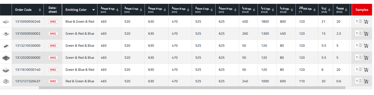

I saved this for the last. It is where I got into depths of the datasheet to make my engineering choice, for my application, it is a critical aspect to choose the correct LED. So first let’s understand the LED’s Optical parameters.
  • Peak Wavelength: The most intense (brightest) color the LED emits.
  • Dominant Wavelength: The color your eye perceives most.
  • Luminous Intensity (Brightness): Measured in mcd (millicandela) Indicates how bright the LED appears from a specific angle.
  • Viewing Angle (Φ 0°): No explanation needed i guess
  • Spectral Bandwidth : How Pure the color is, smaller value means more pure value.
With this known, lets look at the values of each LED's as shown in the Wurth Website
Final LED Selections
Critical Alerts Notification LED:
1315050930246 (Round, 21 mA, high‑brightness alert)
With a flashy 800 Ivr value, It has the highest among all others, and so best to catch the attention of a person for critical alerts and since they are gonna be rarely used, Power is not of a concern here. And will be used in all devices
Hand Held Device Notification LED
1312121320437 (Square, 20 mA)
This was tricky. Initially i proposed  1312020030000 (Square, 5.5 mA) due to its low power draw as for critical alerts there is already an high intensity LED,  but later on second thoughts’ i decided to settle on 1312121320437 which is the third most bright led overall and is also having a small form factor. Actually it is the brightest among the small size LED’s  4 each in wall mounted device (both tileable and halo), 2 in hand held.
Halo Light LED
1311610030140 (Square, 6 mA),
The visibility is from the ring made from a large number of LED’s and it’s LED effects and it should be diffused glow so i need low power and small size also. 24 LED in one ring
Wall mounted LEDs
1315050930002 (Round, 13 mA)
I need uniformity on the hexagonal tile and so the larger the LED the better, high  intensity in all three colors. Power is not an issue. 12 per wall mounted tileable
Status LED
1313210530000 (Dome, 5.5 mA),
It needs to be small, need not be that bright but it definitely has to be low power. What status should it indicate? Errors, charging etc. 2 per device
Power Budget
Device LED Type(s) Current / LED
(mA)
Quantity Total Power (mW) Total Current (mA)
Handheld Device 1312121320437 20 2 200 40
1315050930246 21 1 105 21
1313210530000 5.5 2 55 11
Total – 360 72
Tileable Wall Device 1315050930246 21 4 420 84
1315050930002 13 12 780 156
Total – 1255 251
Halo Wall Device 1311610030140 6 24 720 144
Total – 1195 239
Architecture
Legend:
  • Blue Box - Power
  • Red Box: Peripherals only in wall mounted device
  • Green Box: peripherals only in hand held device
This is the overall system architecture for the AuraAlert device family. At the core of the design is an STM32 microcontroller that handles all coordination. It interfaces with different modules depending on the variant. Power comes from a LiPo battery managed via a PMIC and is regulated through a 3.3V LDO and a 5V boost converter—used for driving high-brightness LEDs and other peripherals. Communication with the ESP32-S3 (only on non-handheld variants) happens over Serial and Interrupt, primarily for audio classification via the I2S microphone. The NRF24 handles radio communication, which is ideal for low-power wake-on-interrupt use cases.
On the handheld variant, there’s also a haptic controller and vibration motor connected over I2C to provide tactile feedback. The Würth Elektronik LED strip is controlled directly by the STM32, and power is routed through the boost converter. This setup allows the design to be modular, power-efficient, and adaptable across use cases like handheld, wall-mounted, and tileable devices. When working in KiCad, I can draw all the parts in a single schematic sheet and simply copy the project to create different layouts for each variant.
Planned PCBs
  1. Handheld Device PCB: A single monolithic board integrating all components. Includes the microcontroller, power management, sensors, radio, critical alert LED, and notification LEDs. Designed for compactness and low power consumption with ergonomic placement of buttons and indicators.
  1. Wall-Mounted Device – Control PCB: The main controller board for wall-mounted variants. Hosts the microcontroller, power and connectivity logic, sound detection circuitry, and critical alert LED. Interfaces with a separate LED module for the main notification light.
  1. Wall-Mounted Device – Tileable LED PCB: A small trapezoidal LED-only PCB designed to be chained into a hexagonal pattern. Houses the main notification LED, optimized for uniform light distribution across tiles.  Supports daisy-chaining for flexible tiling and expandability.
  1. Sector Ring LED PCB (Halo Effect): A modular arc-shaped PCB segment designed to be chained to form a full circular LED ring. Each sector includes a fixed number of addressable LEDs to create a diffused halo glow. Facilitates low-cost manufacturing, easy replacement, and scalable designs.
Feel free to ask doubts and comment and criticize me.

  • embeddedguy
    embeddedguy over 1 year ago
    Nice project.
    You are using many components. For example, STM32, nRF24 and ESP32. Any specific reason for this?
  • arvindsa
    arvindsa over 1 year ago in reply to embeddedguy
    embeddedguy  Good question: let me answer why NRF24. For the hand-held device, power consumption should be minimal, So no WIFI. I can keep the STM32L0 go into sleep and be woken up only when i get radio packets via nrf24's interrupt plus they nr24 has a good mesh capability via the library (RF24Mesh Library).  ESP-Now has no mesh capability.
    Now coming why not use ESP32 alone as it is quite possible to get everything done by ESP32 alone. My answer is Time, running AI Sound spotting, controlling the Communication and the Light effect requires careful coding and task partitioning without which there would be stability experience and i have seen them in the past. Which i don't think it is possible within the time-frame of this challenge. And therefore, extra components is not a concern for me right now.
    My Ideal choice would be nrf5 which can do everything, while having ultra lower also. P.S. I am not very familiar with the NRF SDK so again avoiding it.
  • embeddedguy
    embeddedguy over 1 year ago in reply to arvindsa
    Nice, I have never used nRF24. And I think in the past I have seen many designs have used it in remote control applications such as drones.
    As far as I know, it is old and not recommended for new designs. But still many people are using it also. hum.
    Yes, with nRF5 series perhaps you could do everything together, but it is bit more complex to be honest. Especially for the contest. But you can have a look on nRF21540 FEM that increases the range of Bluetooth communication some 3 folds. That might be interesting use case.!!
  • arvindsa
    Yup, NRF24 is NRND but  is super effective. and yes, I hope one day i can get into the world of nrf5. I actually have atleast 30 nrf52832 chips in my stock for the last 8-9 years and two DK boards also. never touched.

    Thank you for this good post! For the power budget calculation. Here you can refer him to the App Note ANO009 that explains how to calculate the maximum power driven per LED component, if the calculations for the driven current are done assuming that only one color is going to light up, then this is correct. Alternatively he can look at the parameter: IC Total Current on the datasheets of the dual wire which show the maximum driven current automatically.
  • arvindsa
    arvindsa over 1 year ago in reply to Würth Elektronik
    You are absolutely right. Thank you for bringing that up. I did make a mistake while posting it, while in the further design process, i unknowingly corrected myself.
