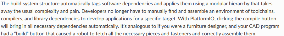

    I can't help you with Arduino things but I looked at the PlatformIO stuff on the web and found this: https://docs.platformio.org/en/latest/what-is-platformio.html I liked the bit that says: It…
  • michaelkellett
    michaelkellett over 1 year ago
    It seems that the gulf between hype and real life is as big as ever. !
    Having said that, you can easily enough delve into the Wurth code on Github - it doesn't seem to be well explained which is all too typical of example code.
    (Almost all the explanation on the Github is about the tools and wrinkles of compiling the code rather than explaining what really goes on. A bit like giving someone a fish rather than teaching them how to catch their own.)
