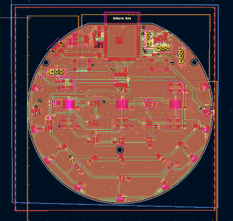

After creating the PCB schematic and layout using KiCad, I had ordered the PCB from NextPCB.
The PCB layout was designed in 4-layers as listed in the following order. To make the design interesting, I kept the PCB in a round shape. This will look more beautiful, and layout also will look nicer. In the end when I receive the PCB and start the LEDs, they would look more organized.
For round shape PCB just a good thing to do is to also place components at particular angle.
  • TOP COPPER TRACKS
  • GND
  • POWER
  • BOTTOM COPPER TRACKS
The following layout image from KiCad shows layers and component placements. I have used some planes in the layout to have power stability and GND return path.
For the LEDs as they require 5V, I have a plane that is below LEDs placements. Hence the third layer below all the RGB LEDs is 5V power plane.
There is 3.3V power plane below 3.3V power domain. There is GND plane on entire layer 2 and copper pour on layer 1 and layer 2 for GND signal.

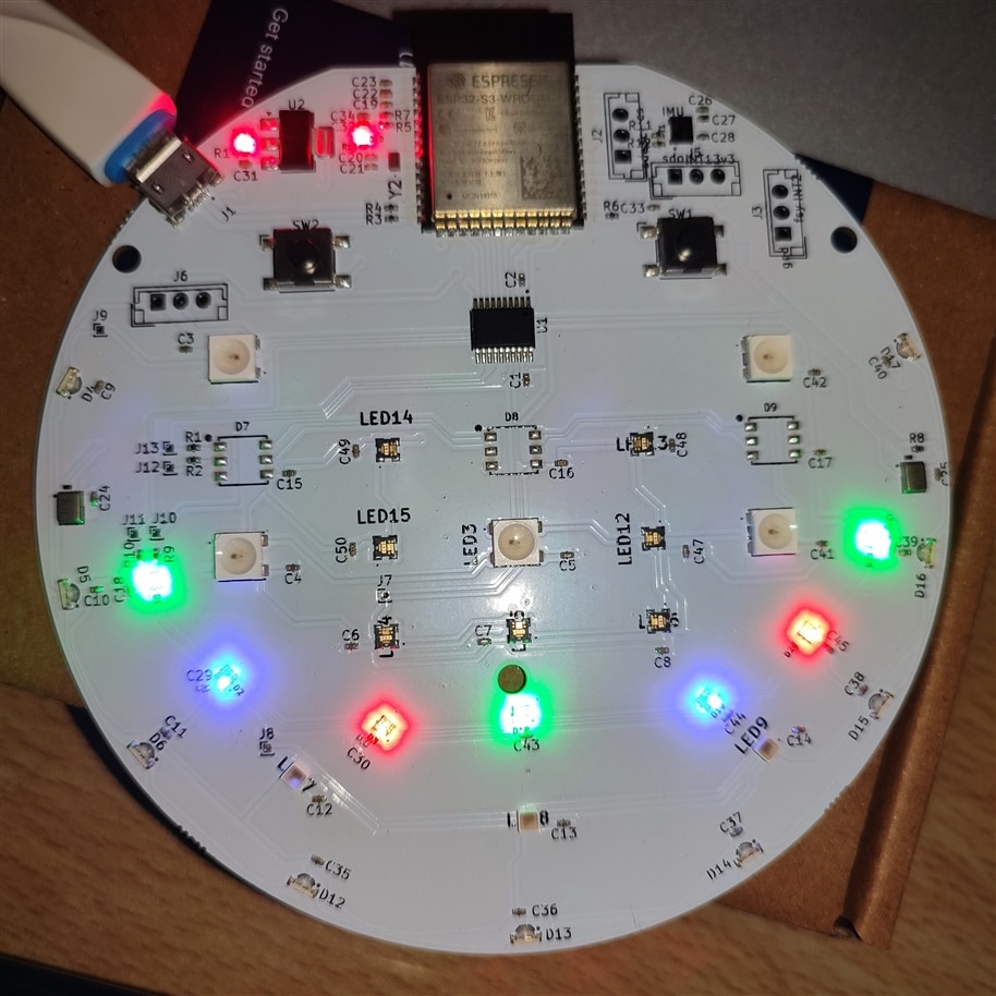

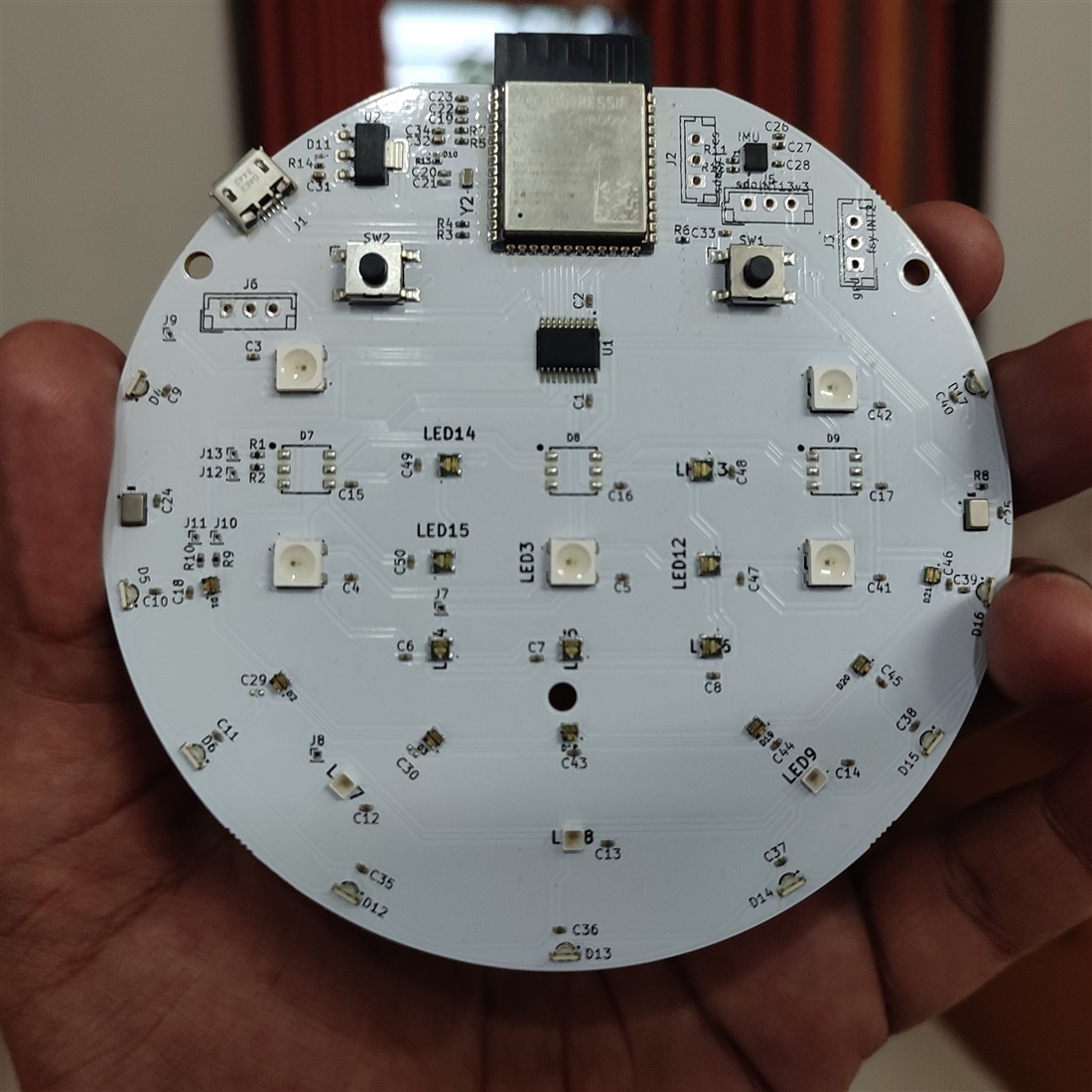

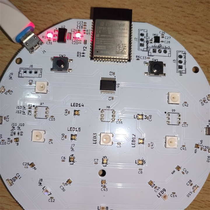

Testing the newly received PCB
I got this assembled PCB some days ago from NextPCB. The actual device looks similar to the one I had designed and viewed in KiCad 3D viewer. But it is always interesting to see the device in real and have a sense of how it looks. So here it is.
Testing Power Supply
Power supply is important design consideration. As in my design it was required to take out 5v USB signal for LEDs and use 3.3v signal for the ESP32 module. I used NCP-1117-3.3 LDO power regulator for this design. The RED LEDs are the indication that the device is working properly. i.e. Power LEDs.
One thing that I was more concerned about was USB signal and impedance matching to 90 ohms. As my calculation for tracks, width and other paameters to calculate impedance and PCB house's suggestions was different, but I went with their suggestion. And it worked.
As soon as I attached the USB it was detected in windows device manager. Now one can upload the code or run the code if I am not in bootloader mode.

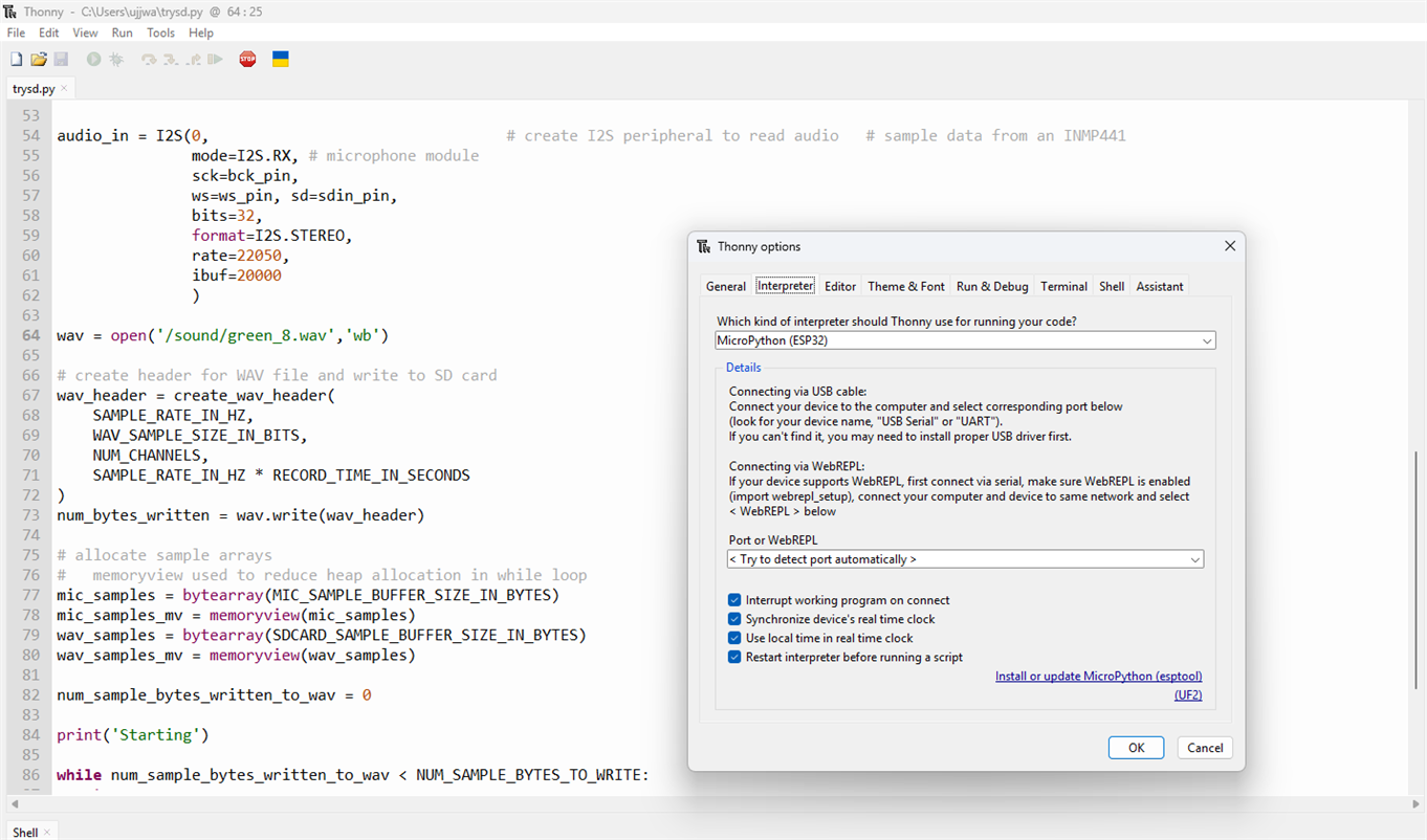

One of the first thing to test esp-32 chip is to load a simple blink or hello world program. This will let us know if the chip is working or not or it is responding or not. I wanted to give a try to Micro python on the first try but one can start with Arduino or esp-idf.
Installing Micro python
Overview — MicroPython latest documentation
Micropython has a good support for esp32 devices. There are many libraries for wireless communication such as Wi-F-/Bluetooth that are supported for esp32 chips.
Also, there is a good support for peripherals such as SPI, I2C, I2S and others. To run Micro python code on esp32 it is required to first flash the firmware on to the device. The following commands will first erase and then flash the firmware on the device.
python -m esptool --chip esp32 erase_flash
python -m esptool --chip esp32 --port COM7 write_flash -z 0x1000 firmware.bin
Next one can use IDE such as Thony to run micropython code. This will configure the IDE to run the code on esp32 device. Micropython supports various packages that you can install using the Thony IDE from Tools > Manage Plugin.

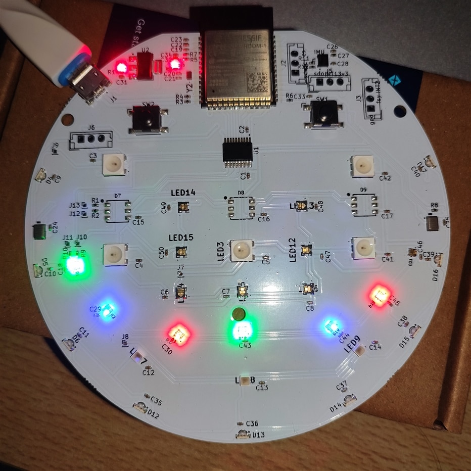

Testing of different LEDs
Mainly there are six different kinds if RGB chip LEDs that is there in the kit. All these LEDs are different. But most of them use same protocol that is compatible with neopixel ws2812b kind of LEDs. But there are two LED types that must be operated using two lines namely clock and data. This can be operated using SPI or similar interface where clock and data rate can be matched that of the LED that is supported in the datasheet. From my side I decided to use SPI interface for this. Because it has both clock and data and needs no extra bits such as address or read/write bit in I2C. But I think I2S can also be used, or a GPIO bit-bang technique can also be used. But why to use complex method when we have simple interface ready to be used such as SPI.?
One of the LED uses 16-bits for each color value. Hence it will also need separate code for it's working. Let's discuss each one of them one by one.

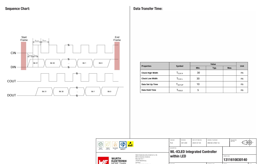

1311610030140 LED
The datasheet for this LED has some information about how to get this LED work. Basically, it can work with SPI protocol with some tuning. One thing is that there is a minimum clock duration of approx. 30 nanoseconds. This implies that the frequency of the SPI clock should not be very high. Also, there are four data bytes to be sent in sequence for each LED. Means if I have three LEDs, then I must send 3x4 = 12 bytes of data. Also, there is a start frame of 32x0 bits. Means four bytes. There is end frame of N/2 bits. So, if I have four LEDs connected, I must send some two bits of data. This is very important to notice. If I turn off the SPI clock just after sending data for color, it will not work. I must keep the clock on for at least N/2 bits cycle. The bit values do not matter.
The frame will be like this
  • 32 bits x 0 > 4 bytes start frame
  • 4 bytes color value
    1. First byte = [0:2] Flag bits, [3:7] global current gain value
    2. second byte (Green) + Third byte (Blue) + Fourth byte (Red) values
  • End frame of N/2 bits where N = Number of LEDs
Here is the Python code for this LED.

At first, I forget to send the end frame hence the last LED is not ON in the first picture above. Then the last LED is green colored.!Blush

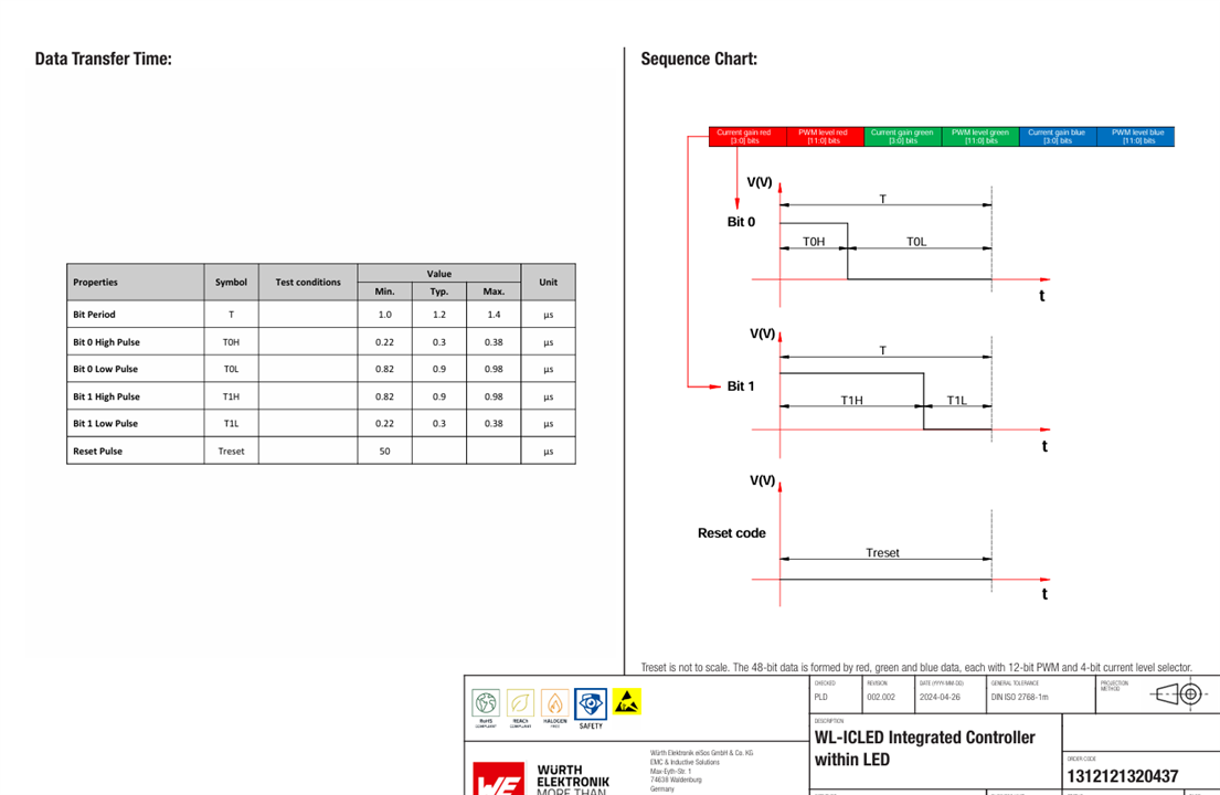

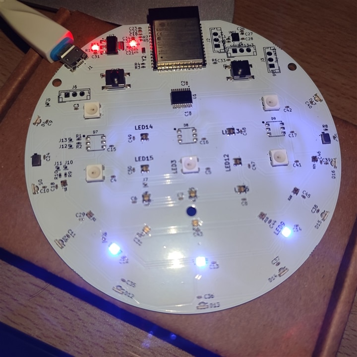

1312121320437 LED
This LED is also different in terms of protocol it works with. Also, this is the LED with Bypass signal. Means if a specific LED is not working then the next LEDs in the series will still work. This can be done by connecting a bypass signal. The LED chip is smart enough to determine that the DOUT of the previous LED has malfunctioned. It will take the input of the previous LED and on BI pin and let the other LEDs connected in series work as expected.
From the datasheet of the LED, it is clear that the LED works similar to ws2812 kind of protocol. But there is some significant difference. First, the data values are 16-bit for each color. The first four bits are for current gain value for each color (0 means no gain and F means highest). Then there is eight-bit color value for each color.
The total time period of a specific bit (0 or 1) is 1.2 us. With high/low time ranging between approx. 0.3 us to 0.9 us. These timing values must be followed to generate signals for the LEDs. At first, I tried to do this with PWM module in micropython but that will not work as PWM is slow in changing duty cycle. Then the option was to use SPI to encode the LED data values and send it over. Also, SPI can be fine-tuned to have accurate pulses.

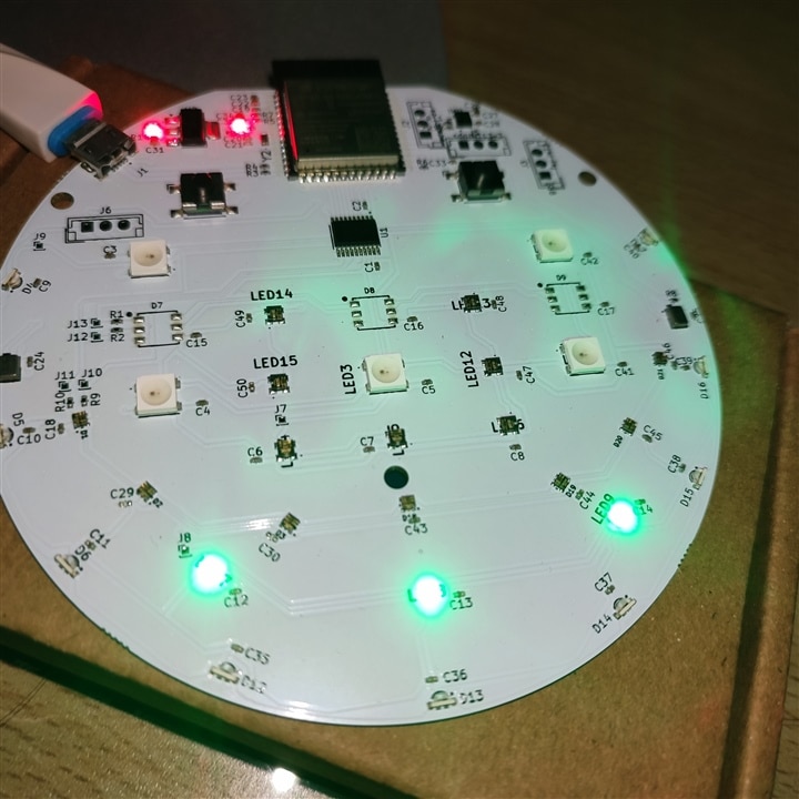

Here is a simple code to make these LEDs work as expected. I have three LEDs connected in series. I can change the color and current gain using the following code.

Let the pictures explain it all.
At first the LED is OFF. Then the LEDs turns bit bright. This is because the value for red in the above code is 0x100F. The it turns bit low brighter because the value of red is 0x1001. This is the effect of lowering the current gain. The last is highest current gain and highest bit color intensity value. That is 0xFFFF.

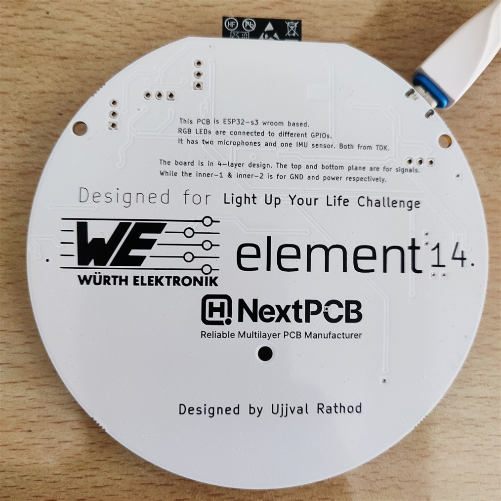

  • embeddedguy
    embeddedguy over 1 year ago in reply to JoRatcliffe +3
    BTW I have element14 on it in the backside, I forget to upload that.

    Regarding the N/2 bits for the end frame, please keep the DIN line on high (so that the end frame is buildup of 1-bits). In case the DIN line is set to low, then the IC will start reading the extra clock…

  • embeddedguy

    Regarding the N/2 bits for the end frame, please keep the DIN line on high (so that the end frame is buildup of 1-bits). In case the DIN line is set to low, then the IC will start reading the extra clock cycles as bits 0 and might result into the IC reading a new “Start Frame” without having fully transmitted the information of the first command (this is specially important when working with long LED strips > 64 ICLEDs).
    Also so cool to see you put the logos at the bottom. Just maybe as a side note from markting side you used our old logo on your PCB  so if you do a new PDC design you could use our new one :D

    Würth Elektronik Excuse the delayed response. I just saw your response now.
    Yes, thank you for your response. Well, for now it is working and as you might have seen, I changed the code and sending the END_FRAME. That worked as expected.
    Yes for more LEDS I might need more bytes to be sent. I will always send (0xFF) or similar for end frame so that data line is set high.
    Oh, I see, I would change it for next PCBs if I use that. And chances are high that I will use that. I will put the right LOGO.!
