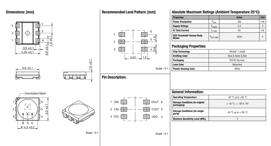

The kit includes several types of LEDs, perfect for different lighting experiments. The parts I am looking to evaluate and experiment around through this project are:
  • 5x5 LED 1315050930002, 1315050930246
  • 2x2 LED 1312121320437
  • Flat 4-pin LED 1313210530000

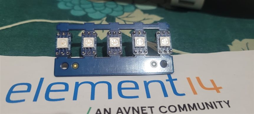

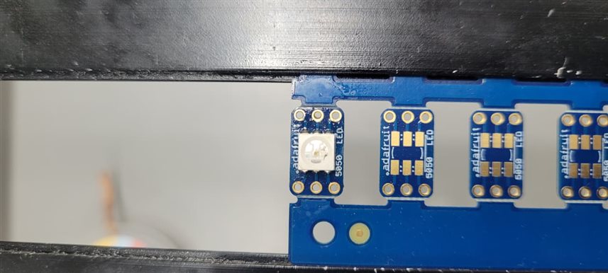

Soldering the LEDs
The LEDs have nicely exposed pads on the side and large pads, making soldering easy and clean for both newbies and pros alike.

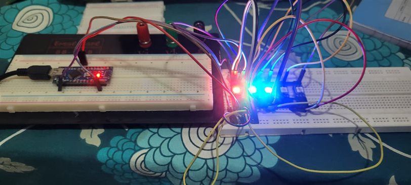

Wiring it up with Arduino
I decided to start simple with an Arduino Nano for easy setup. The LEDs I’m using are 4-wire 5050 models (P/N 1315050930246) - great because they pair well with breakout boards and are primitive, familiar ones to start with.
Here’s how I connected the LED pins to the Arduino Nano:
LED Pin Function Arduino Pin
PIN 1 (DIN) Data Input D6
PIN 2 (CIN) Clock Input D7
PIN 3 (VSS) Ground (GND) GND
PIN 4 (VDD) Power (5V) VIN (5V)

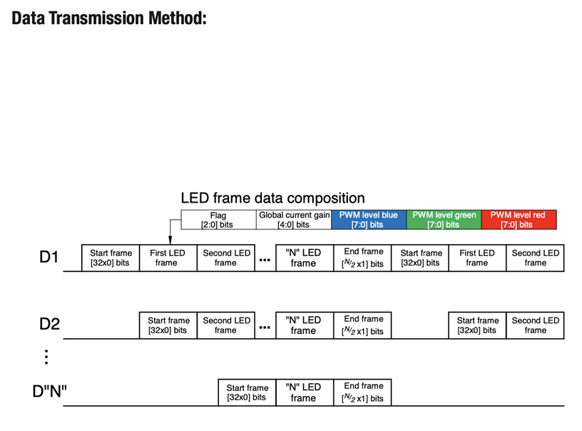

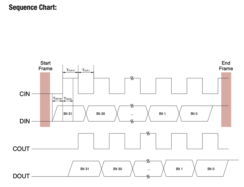

After some datasheet errands, understanding the frame formats and helping hand from GPT, I wrote a basic sketch. And boom! The LED blazed up
Bringing up Colours
Wanting to control RGB LEDs individually, I tailored the sketch to manipulate each LED's colour. Then, I wondered if existing LED libraries could help. After trials, I found the FastLED library worked perfectly since it’s compatible with APA102 LEDs, which share communication protocols with these Wurth LEDs.
Grab my FastLED sketch here
