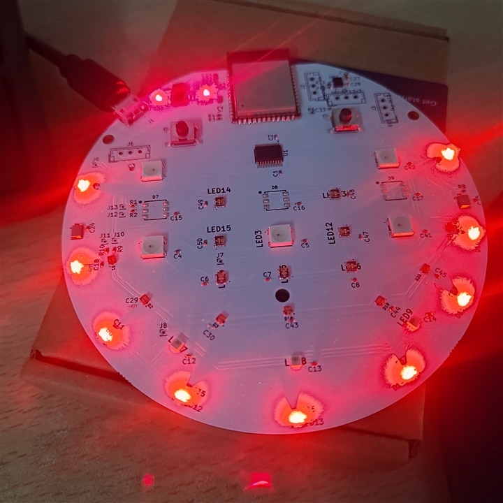

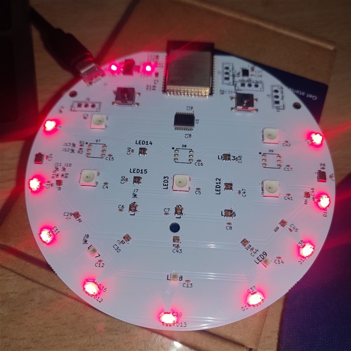

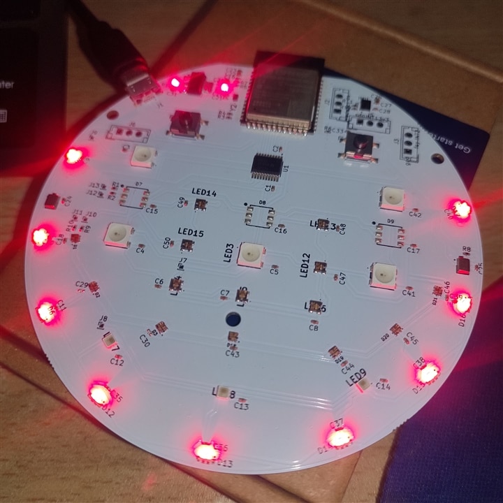

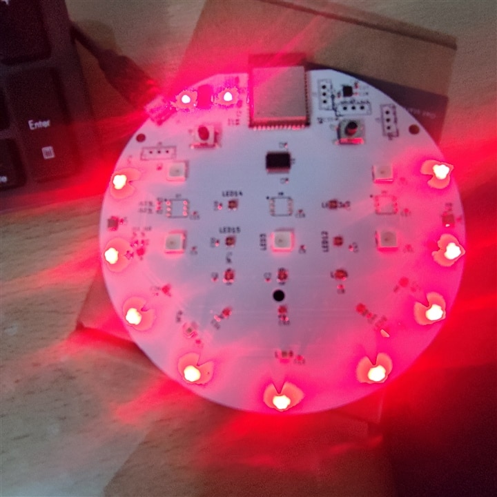

1313210530000 LED
From all the LEDs in the kit this one is the smallest one. When I started creating PCB, I thought that it would be nice to place these LEDs on the rounded corner of the PCB. This LEDs are suitable for tiny size requirements or to create some designs on the PCB like letters or logo etc. due to its small size. It is compatible with Neopixel library.
{gallery}LEDs
1313210530000 LED: Tiny corner mounted

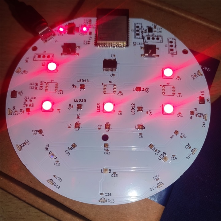

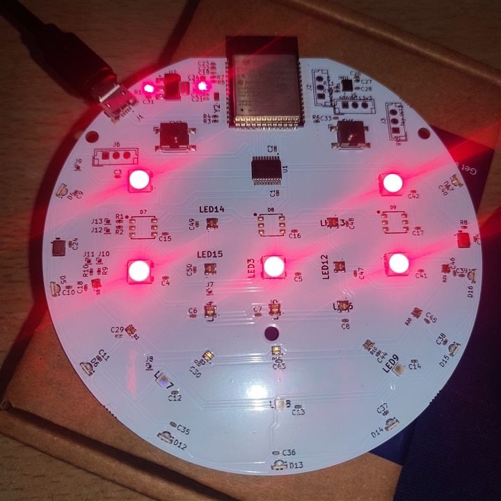

1315050930002 LED
These LEDs are somewhat big in size and has 4 pins. In my opinion this is exact replacement of ws-2812b type of LEDs. It is suitable for lighting application in home, office or anything similar. It can change colors so can be used for applications that require color

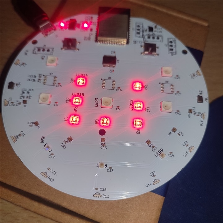

1312020030000 LED
These are tiny LEDs that can run with Neopixel format. These are also tiny LEDs with nice color spread. It can be used for decorative lights, home applications and other similar applications.

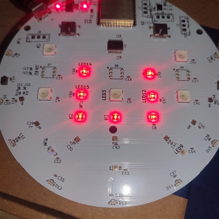

Controlling LED color using Wi-Fi
ESPNOW is a Wi-Fi based protocol for wireless communication. It offers simple point-to-point connection between devices.
With ESPNOW it is possible to connect upto 20 devices simultaneously. The protocol does not require complex setup and AP/STA mode requirements.
Another advantage is that ESPNOW can operate for quite long range than traditional Wi-Fi or Bluetooth communication. It can range up to 1.2 kms. This makes it quite suitable for smart light and remote control-based application.
For now, I have tried a simple remote control to change LED color to either RED, GREEN or BLUE based on the status of the push button press on the sending device.
Use of remote control to change LED light color and intensity is more common than using something else. Like for example WiFi or Bluetooth. It eliminates complex setup and cost related to software development and it's faster than other methods. Also, security is not an issue with remote control.
In the Python code for control of the colors of LEDs one just need the MAC address of the sender and the receiver node for point-to-point communication.
Here is the code for sender node. The sender node checks for push button press and if a specific button is pressed then the color on the other side will change to specific color. There are only three pushbuttons so only three colors are possible.
#This is a sender for changing LED colors based on button values
import time

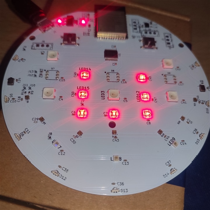

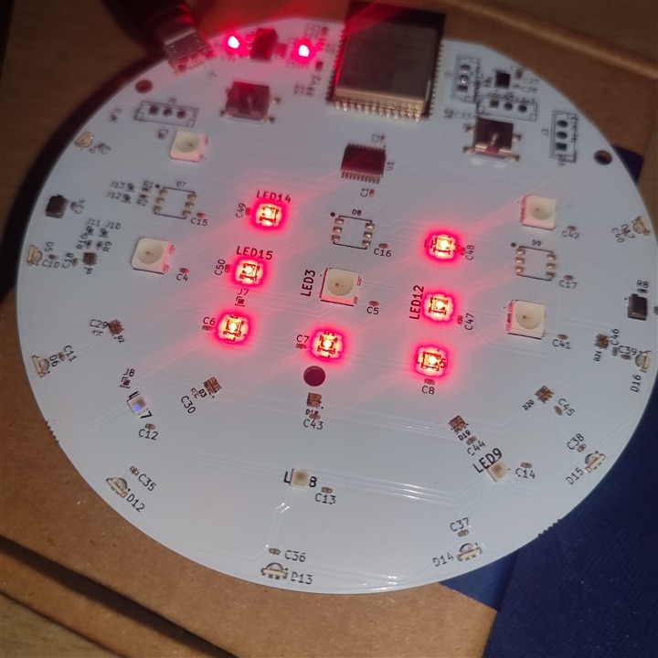

Here is the code for the receiver node. In this case the RGB-Matrix PCB. The code continuously checks for new values on ESPNOW network and changes the color of the LED if there is a new value.
# 7C:DF:A1:07:BE:A6
# Receiving the espnow packate and changing the LED colors to RED | GREEN | BLUE
