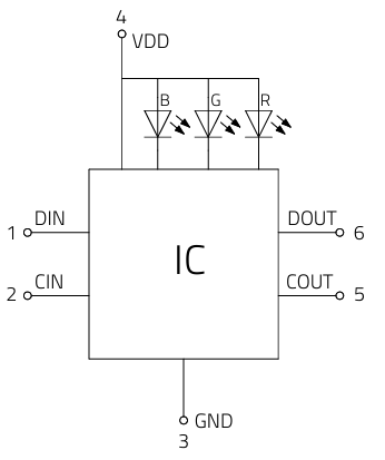

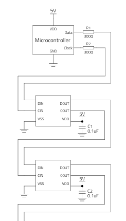

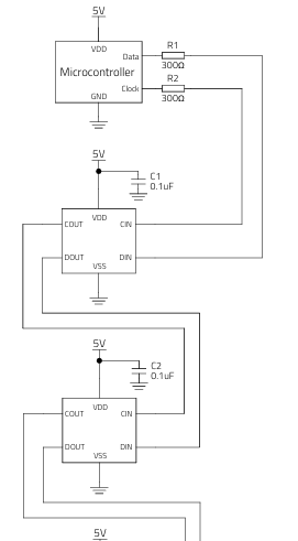

1.1 Model 1311610030140: Chip IC RGB LED Compact
This is a compact chip-level RGB LED controller with a 6-pin configuration (COUT, VDD, CIN, DOUT, VSS, DIN) and a waterclear plastic housing. Its key specifications include:
  • Electrical Limits: 5.5V supply voltage, 100mW power dissipation, 17.5mA total IC current, and 4000V ESD tolerance (Human Body Model, HBM).
  • Optical Performance: Peak wavelengths of 630nm (R)、520nm (G)、465nm (B); luminous intensity ranges 40-80mcd (R)、60-120mcd (G)、15-50mcd (B); and a 120° viewing angle.
  • Wiring Design: Utilizes a synchronous clock-data (CIN/COUT) + serial data (DIN/DOUT) architecture. CIN (Clock In) and COUT (Clock Out) handle clock signal transmission, while DIN (Data In) and DOUT (Data Out) manage serial data, enabling cascading of multiple LEDs. The 32-bit frame data includes 3 flag bits, 5 global current gain bits, and 8-bit PWM levels for each color (G→B→R order), with a 20kHz PWM frequency. A 1ms wake-up time is required after exiting sleep mode.
  • Application: Ideal for compact, low-power scenarios (e.g., small indicator lights) due to its miniaturized chip form and moderate current output.
The size of 16x16 mm with
and the schematic

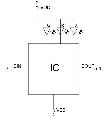

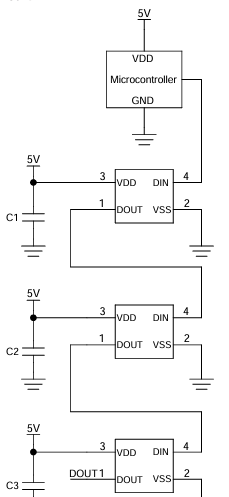

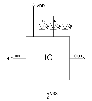

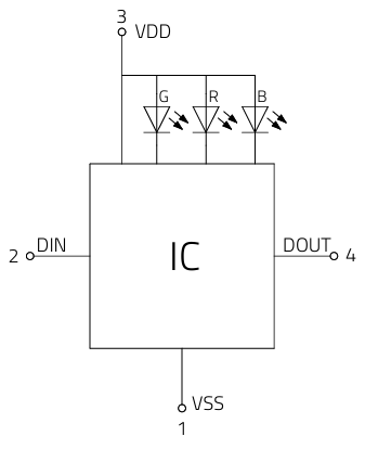

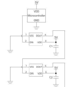

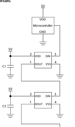

1.2 Model 1312020030000: Chip LED Compact IC RGB
A 4-pin compact chip controller (VDD, DIN, DOUT, VSS) with a waterclear lens, optimized for simplified serial communication. Key traits:
  • Electrical Limits: 5.5V supply voltage, 110mW power dissipation, 6.5mA max IC output current, and 4000V ESD tolerance.
  • Optical Performance: Identical peak wavelengths to 1311610030140, but with a lower PWM frequency (4-6kHz) and matching luminous intensity ranges.
  • Wiring Design: Eliminates dedicated clock pins (CIN/COUT) and adopts a 2-wire serial interface (DIN/DOUT). Data is encoded via pulse width modulation (PWM): Bit 0 uses a 0.15-0.45μs high pulse (T0H) and 0.75-1.05μs low pulse (T0L), while Bit 1 uses a 0.75-1.05μs high pulse (T1H) and 0.15-0.45μs low pulse (T1L). A >200μs reset pulse initializes communication. The 24-bit data frame is ordered G→R→B (8 bits each), with MSB (Most Significant Bit) first transmission.
  • Application: Suited for cost-sensitive, space-constrained designs (e.g., consumer electronics indicators) where simplified wiring reduces PCB complexity.
The size of 20x20 mm
schematic

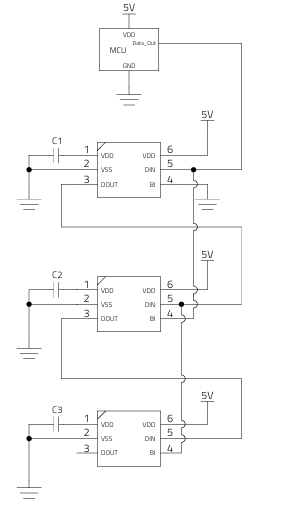

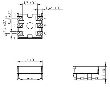

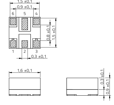

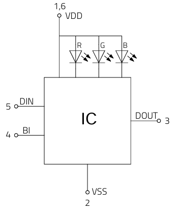

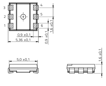

1.3 Model 1312121320437: SMT PLCC6 IC RGB LED
A surface-mount (SMT) PLCC6 (Plastic Leaded Chip Carrier 6-pin) controller with a diffused white housing, designed for high-brightness, industrial-grade applications. Key specifications:
  • Electrical Limits: 5.5V supply voltage, 380mW power dissipation (3.8x that of 1311610030140), 23mA max IC output current, and 2000V ESD tolerance (lower than other models). It also includes a BI (Bypass) pin for emergency shutdown.
  • Optical Performance: Significantly higher luminous intensity (400-600mcd R、700-1000mcd G、160-240mcd B) and narrower spectral bandwidths (14nm R、28nm G、18nm B) for more precise color control; 110° viewing angle.
  • Wiring Design: Features a 6-pin configuration (VDD1, VSS, DOUT, BI, DIN, VDD6) with dual VDD pins (1 and 6) for stable power delivery in high-current scenarios. The BI pin allows direct bypassing of the controller to turn off LEDs instantly. Data transmission uses 48-bit frames (12-bit PWM + 4-bit current gain per color, R→G→B order) and a low PWM frequency (0.5-0.7kHz) to prioritize brightness stability over flicker reduction. A 50μs reset pulse is required, shorter than most models.
  • Application: Industrial lighting, large display panels, or outdoor indicators, where high brightness and robust power handling are critical.
the size of 22x 22 mm
schematic,
Pin 1 and Pin 6 both are VDD for easy power access

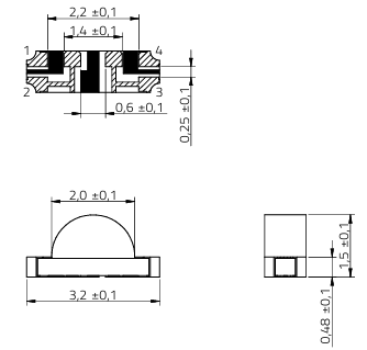

1.4 Model 1313210530000: Side View IC RGB LED
A 4-pin side-emitting controller (DIN, VDD, VSS, DOUT) with a waterclear lens, designed for edge-lighting scenarios. Key traits:
  • Electrical Limits: 5.5V supply voltage, 110mW power dissipation, 6.5mA max IC output current, and 4000V ESD tolerance—matching 1312020030000.
  • Optical Performance: Identical peak wavelengths and luminous intensity to 1312020030000, but with a side-emitting optical design (120° viewing angle) for edge illumination.
  • Wiring Design: Shares the 2-wire serial interface (DIN/DOUT) of 1312020030000, with identical bit timing (T0H、T0L、T1H、T1L) and 24-bit G→R→B data frames. The only physical difference is the side-mounted pin layout, which requires PCB traces optimized for edge placement.
  • Application: Edge-lit displays (e.g., LCD backlights, automotive dashboard indicators) where light emission from the side is required.
the size of 32x16 mm
schematic

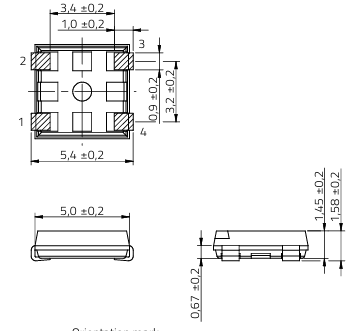

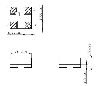

1.5 Model 1315050930002: SMT PLCC4 IC RGB LED
A 4-pin SMT PLCC4 controller (VSS, DIN, VDD, DOUT) with a diffused white housing, balancing brightness and compactness. Key specifications:
  • Electrical Limits: 5.5V supply voltage, 240mW power dissipation, 14.5mA max IC output current, and 4000V ESD tolerance.
  • Optical Performance: High luminous intensity (280-450mcd R、900-1300mcd G、150-260mcd B) and 120° viewing angle, with spectral bandwidths matching 1312121320437.
  • Wiring Design: Uses a 4-pin serial interface (DIN/DOUT + VDD/VSS) with unique bit timing: Bit 0 (T0H=320-400μs, T0L=800-900μs) and Bit 1 (T1H=640-800μs, T1L=350-400μs)—slower than 1312020030000 to improve data stability. The 24-bit G→R→B data frame and >200μs reset pulse are consistent with 4-pin chip models, but the PLCC4 package allows for easier SMT assembly than chip-level designs.
  • Application: Mid-brightness applications (e.g., home automation panels, retail signage) where SMT compatibility and moderate brightness are needed.
the size of 50x50 mm
schematic

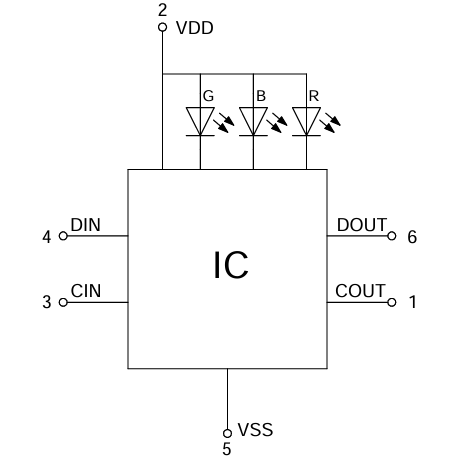

1.6 Model 1315050930246: SMT PLCC6 IC RGB LED
A high-performance 6-pin SMT PLCC6 controller (DIN, CIN, VSS, VDD, COUT, DOUT) with a diffused white housing, designed for high-current, high-brightness cascading. Key traits:
  • Electrical Limits: 5.5V supply voltage, 360mW power dissipation, 65mA total IC current (highest in the series), 21mA typical IC output current, and 4000V ESD tolerance.
  • Optical Performance: Highest luminous intensity in the series (560-800mcd R、900-1800mcd G、285-400mcd B) and 120° viewing angle, with 20kHz PWM frequency for flicker-free operation.
  • Wiring Design: Revives the clock-data (CIN/COUT) + serial data (DIN/DOUT) architecture of 1311610030140 but optimizes it for high-current cascading. CIN/COUT handle synchronous clock signals (30ns min clock high/low width), while DIN/DOUT manage serial data (10ns setup time, 5ns hold time). The 32-bit frame data includes 3 flag bits (with sleep mode enable via 3’b101), 5 global current gain bits, and 8-bit PWM levels (B→G→R order). A 1ms wake-up time and 20kHz PWM frequency make it suitable for high-density LED arrays.
  • Application: Large-scale lighting systems (e.g., architectural lighting, stage lights) where cascading multiple high-brightness LEDs is required.
schematic

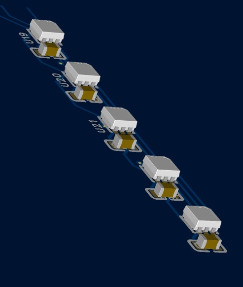

3.1 Model 1311610030140: Chip IC RGB LED Compact
This is 6 pin Chip IC LED with clock and datain , in some specification it is classified asSPI chip IC LED, since clock pin is used.
Thus 3000ohm resistor shal be used to control leaky current

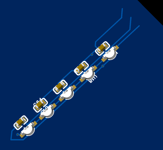

Here is the PCB design with 3D

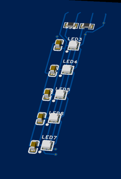

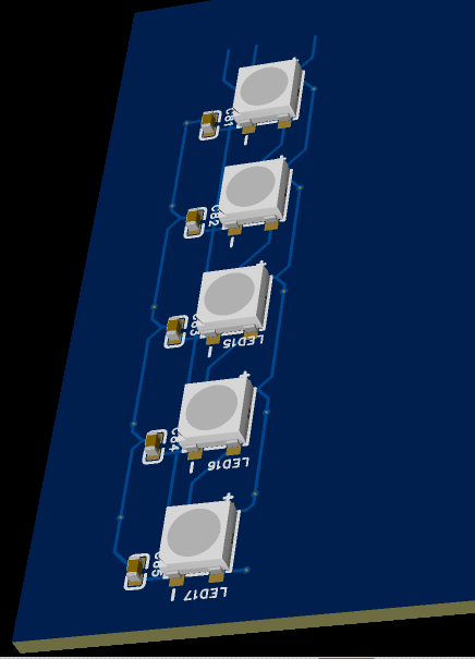

3.2 Model 1312020030000: Chip LED Compact IC RGB
This is simple topography with only DataIn and DataOut pin to control the Chip IC
Here is 3D PCB design

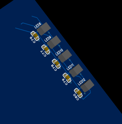

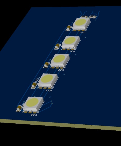

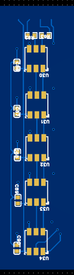

3.3 Model 1312121320437: SMT PLCC6 IC RGB LED
This is one of interesting design, since BI pin is used . The BI pin allows direct bypassing of the controller to turn off LEDs instantly. This give interesting application such as for emergency purpose.

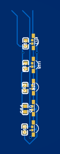

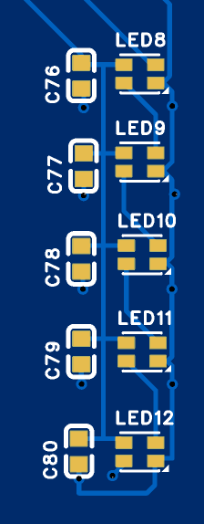

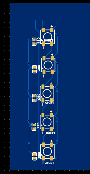

3.4 Model 1313210530000: Side View IC RGB LED
It appears normal with DataIn and DataOut pin only, but the variation in PAD position give more control over PCB Design
PCB design as

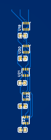

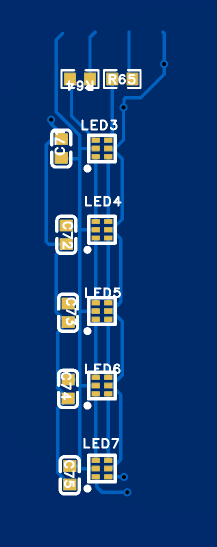

3.5 Model 1315050930002: SMT PLCC4 IC RGB LED
Another typical 4-pin configuration
PCB design as
