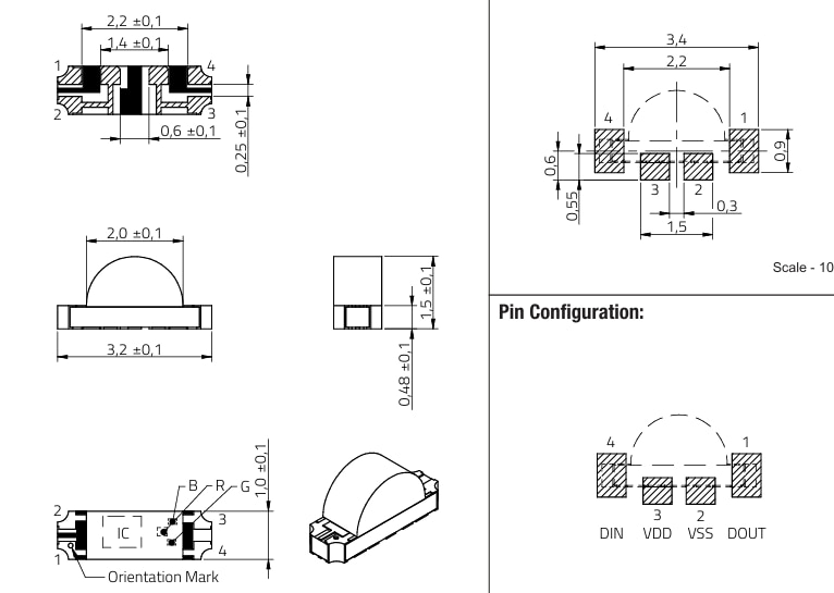

Just briefing the solder method for WL-ICLED with the 4-pin production,  1312020030000, 1313210530000, 1315050930002, since there are  still some problems driving 6-pin.But the principle are the same.
The soldering methods include using a soldering iron, hot air gun, and soldering station.
1.1 Characteristics of the LEDs
  • Package Type: All are 4-Pin SMDs – 1313210530000 (Side View SMD), 1312020030000 and 1315050930002 (PLCC4 package). They feature standard pin pitch (typically 2.0-2.5mm, no ultra-fine pitch) and a small number of pins, resulting in moderate soldering difficulty.
  • Key Sensitivity: LED chips are heat-sensitive (maximum tolerance: ≤260℃ for ≤10 seconds). Pins are prone to oxidation; cold solder joints and bridging must be avoided.

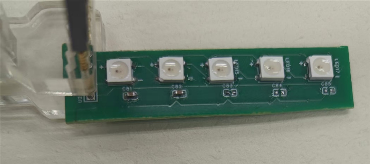

2 Solder iron used for 1315050930002

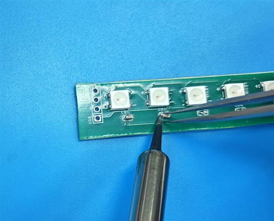

2.1 Soldering Iron Method (Manual Point-to-Point Soldering)
Soldering Steps
  1. Component Positioning: Place the WL-ICLED SMD accurately on the PCB pads, ensuring all 4 pins align with the pads (note the pin orientation of the Side View product 1313210530000 to avoid reverse mounting).
  2. Temporary Fixing: Hold the component with tweezers, dip the soldering iron in a small amount of solder, and solder one pin to temporarily secure the component. Check for misalignment.
  3. Full Soldering: Solder the remaining 3 pins sequentially. Touch both the pin and pad with the iron tip, feed solder wire after 1-2 seconds, and remove the solder wire first, then the iron once the solder uniformly wets the pin-pad junction (forming a smooth solder joint).
  4. Cleaning & Trimming: Use desoldering braid to remove excess solder (preventing bridging) and wipe residual flux with anhydrous ethanol.
Like this, this is photo for capacitor, same to the 1315050930002.

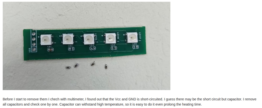

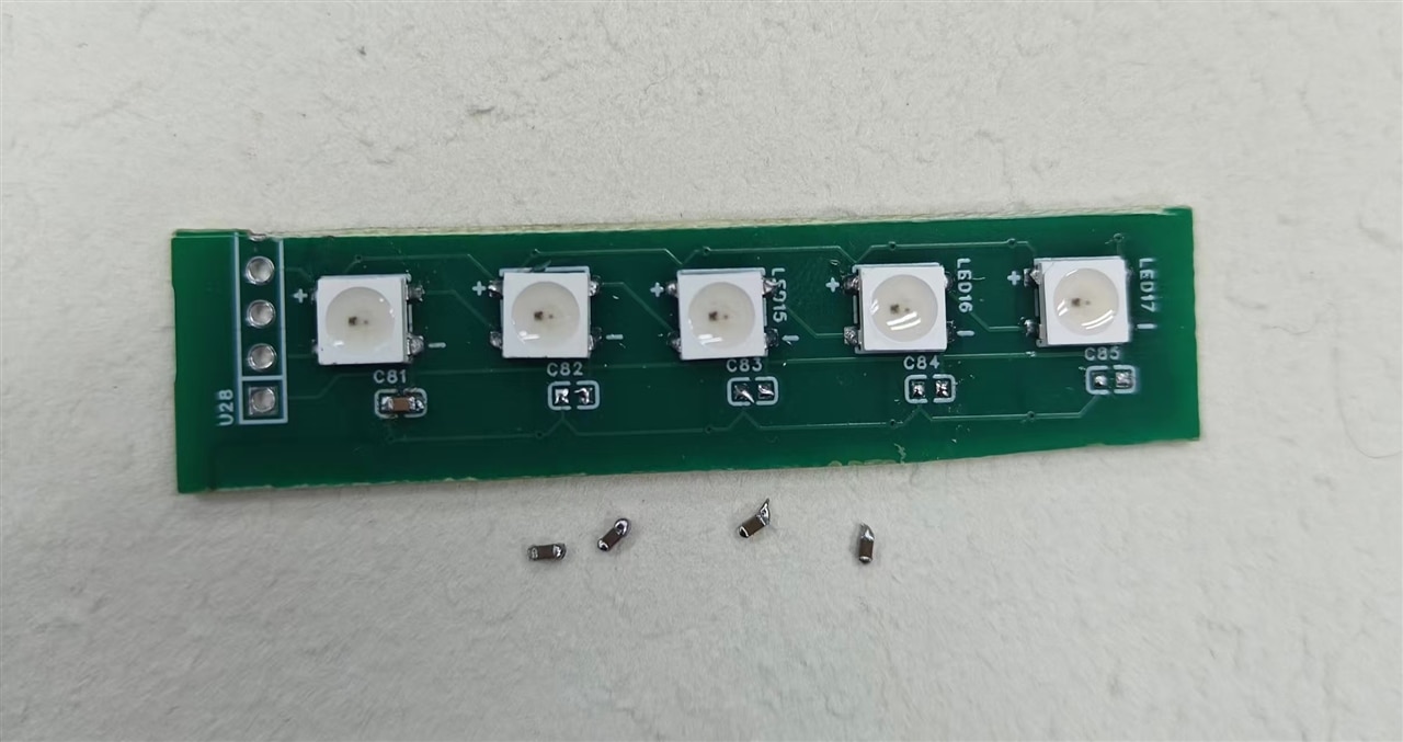

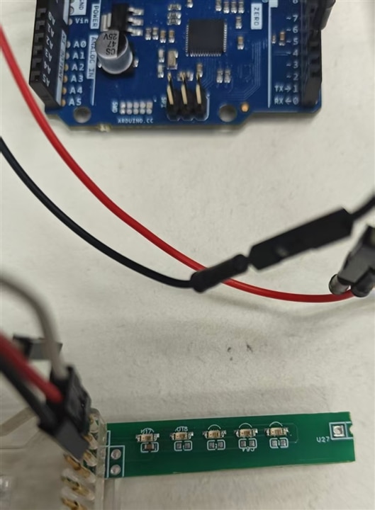

I am too quick in put everything in place. But  it frustrated me with the five WL-ICLED black out. It is liable to overtemperature and break the LED with solder iron. I have to remove them all to check one by one.
Before I start to remove them I chech with multimeter, I found out that the Vcc and GND is short-circuited. I guess there may be the short circuit but capacitor. I remove all capacitors and check one by one. Capacitor can withstand high temperature, so it is easy to do it even prolong the heating time.

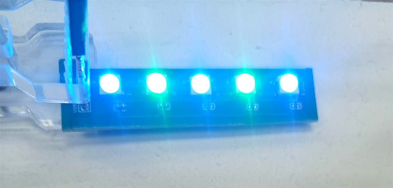

Yes, it works. The solding for LED is OK, save lots of time for me.
This video shows one bug from software, there are two LED skipped. Only three ones blinks. I shall explain later in next post. That is ineresting foundout. Anyway, solder is Good.
The solder iron is quick and easy to use. Even for smaller parts, that is OK. But temperature control need skill and experience.

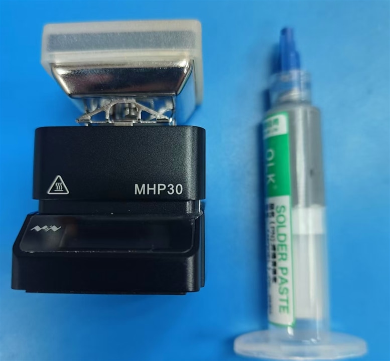

3.1 Solder plate -Soldering Station Method (Temperature-Controlled Platform + Auxiliary Tools – Nearly Professional-Grade Soldering)
It is not difficult to buy one solder plate and solder paste. This is mini-version of solder station, in fact it is just one normal solder plate.

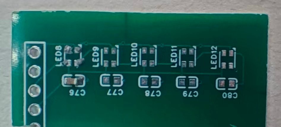

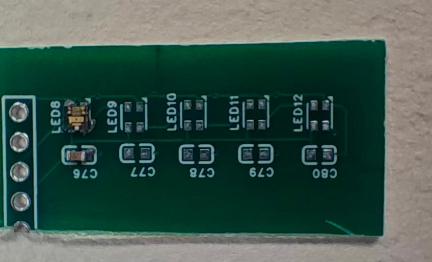

3.2 For 1312020030000
Prepare the PCB and apply solder paste, put first capacitor in place.
Position all the 1313210530000 leds,
no need to worry about the precise position. If the paste applied evenly, the melted paste can pull the led in right position in the end.
It is preferrable to finish one LED first to confirm the polarization
as the video shows,
Then put all others in same manner. But things is not always go easy , the middle one(the 3nd ) led is not blinking .
After visual inspection, I find out that there paste is not evenly applied on all four-pin. So, it is pull off original position and off-load one of the pin.
I use simple solution to fix it. Put it on solder plate and heating again and take off the solder plate and cooling the PCB. AND, press the LED in right position  on PCB with a tweezer until it cool down.

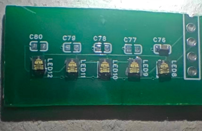

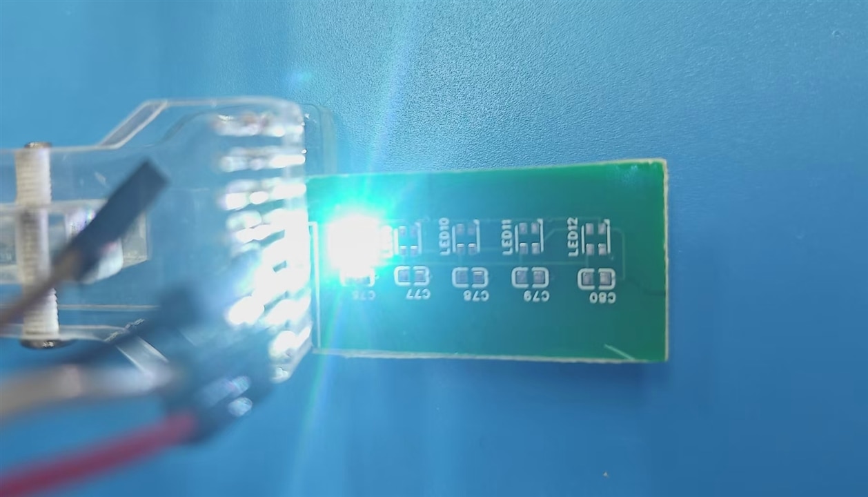

3.3 For 1313210530000
This is smallest PCB of all six LEDs, and it is side view LED.
I have made a mistake in PCB design. I select wrong model and the arrangement of PIN pad is different. the PIN  pad 2 and 3 shall be in opposition side.
Once I appliy solder paste bit by bit and finish routine solder process, the LED is always black.
What a mistake. I do not have enough time to revise the design and order new PCB again.
I have to use one silly step again. apply minimum solder paste and solder 1313210530000 led one by one. As described above, repositoin the LED with tweezer during cooling down.
And finally, all positioned.
And luckly, all work fine.

    Just to confirm my understanding. You soldered all LED's and capacitors to a PCB to discover a short between ground and VCC. Later you make mention of a PCB board design error. It appears you got the…
  • colporteur
    colporteur 11 months ago
    Later you make mention of a PCB board design error.  It appears you got the circuit to work. What the short one issue or a combination?
  • colporteur
  • fyaocn
    fyaocn 11 months ago in reply to colporteur
    One of capacitor is broken due to overheating. Find and remove it make the ICLED works again.
