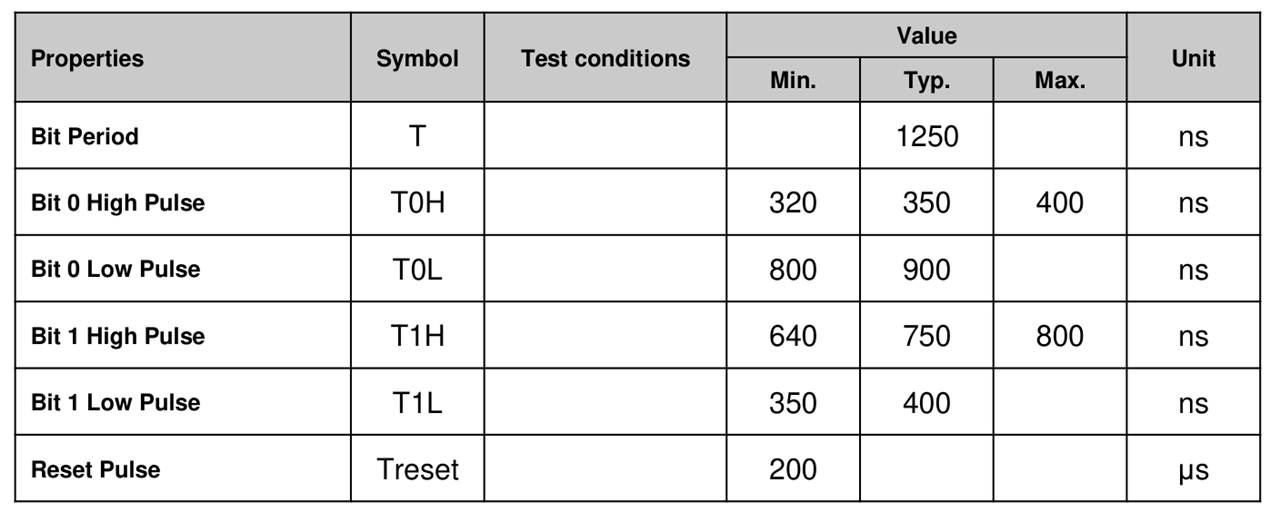

Hello. I welcome you to forum post describing my next experiment with Würth Elektronik WL-ICLEDs. In this forum post I will look at opportunity to combine 24-bit and 48-bit LEDs on single chain. It can be quite useful if you work on project which has several types of LED like some LED matrix and diagnostic LEDs. In such project it makes sense to make LED matrix from more advanced 48-bit LEDs (Würth number 1312121320437) while diagnostics RGB LEDs can be just simple classic 24-bit LEDs (Würth number 1315050930002). Normally you would need to control two buses, but if you read datasheets carefully, you notice that timing of the signal is almost the same. Just amount of data transferred per LED and data encoding differs. For classic LEDs (like 1315050930002), the timing requirements for signalling are:
Data signal timing of 1315050930002 LEDs

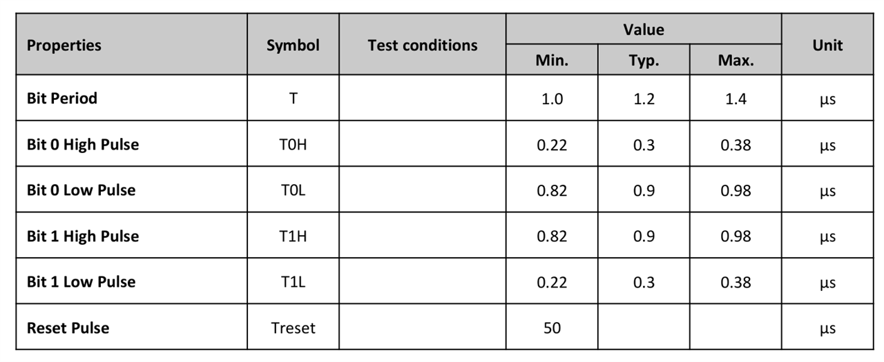

For 48-bit LEDs like 1312121320437, signalling requirements are:
Data signal timing of 1312121320437 LEDs
They use different unit, so it may look confusing at the first look, but actually times are very similar. Actually, it is not possible to find any single value, which satisfies all minimum and maximum when implementing using SPI peripheral. But class 24-bit LEDs are much more tolerant. I stick to following typical values for 48-bit LEDs and slightly violate 24-bit signalling because they are more tolerant. In practice, it works.
