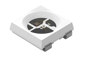

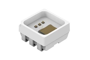

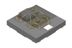

2. Würth Elektronik 1315050930002
Photo of LED Photo of LED bottom image
One of the 5050 PCB-size LEDs, which is a big plus. Also has 4 pins instead of 6, so soldering is a bit easier. Nice and bright output, much more than just a basic indicator LED. Diffuse plastic lens color and viewing angle 120 degrees. All signs point to this being a great option for what I need.

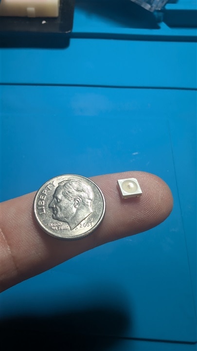

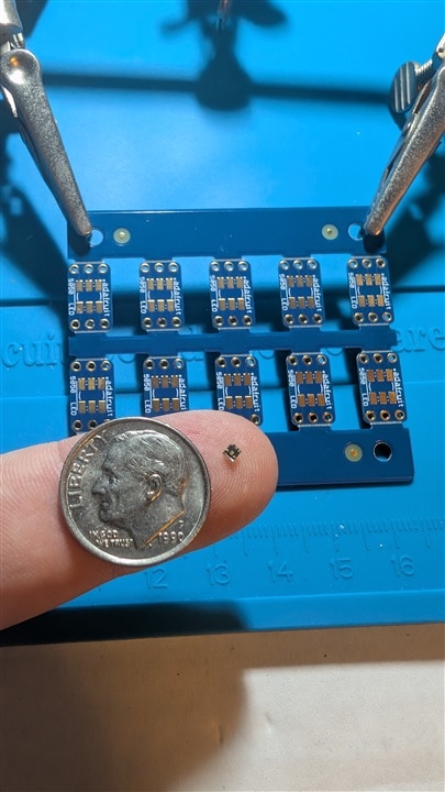

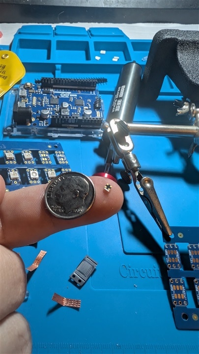

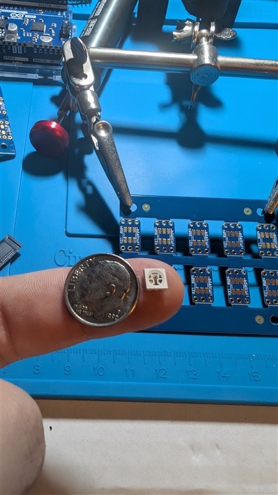

3. Würth Elektronik 1313210530000
LED on finger with dime for scale LED on finger with dime for scale image
I love the physical design of this one with the bubble dome lens. That said, anyone who can solder this correctly on their first try is a wizard and not to be trusted. 4 pins is nice but the footprint is so tiny I just wasn't able to get this to work without bridging when I tried. Will try again after I've had more practice and prototyping time.

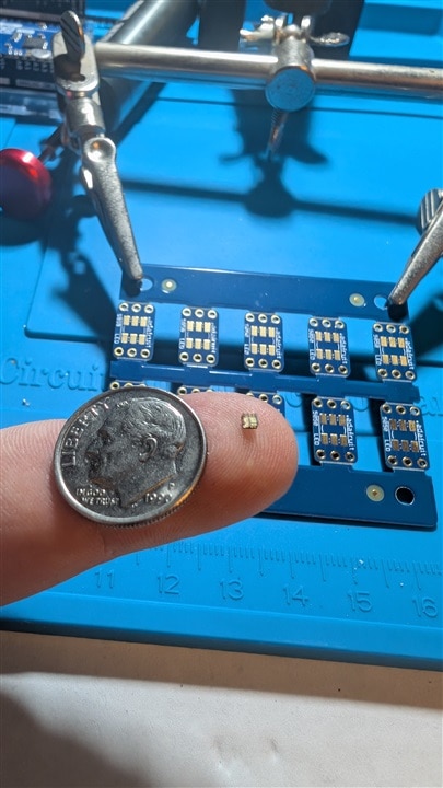

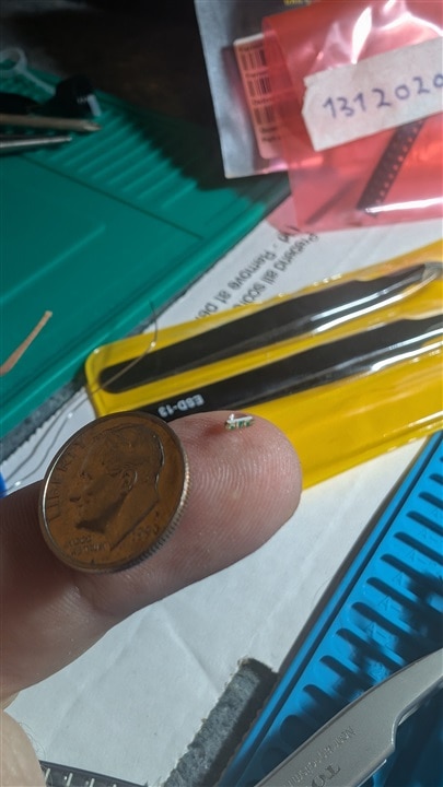

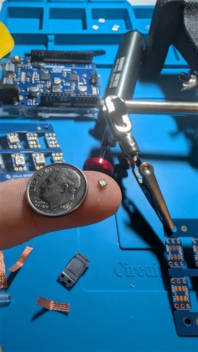

4. Würth Elektronik 1312020030000
Just simply too small for what I can realistically solder right now. And the brightness level is lower than what I was hoping to use for illumination.

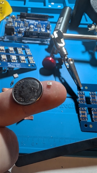

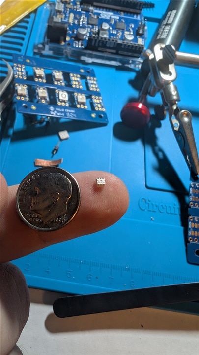

5. Würth Elektronik 1312121320437
Surprisingly bright output, but still awfully small footprint and 6 pins instead of 4. Props to Würth for getting such good output from such a small component.

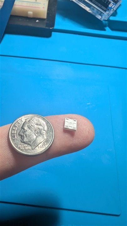

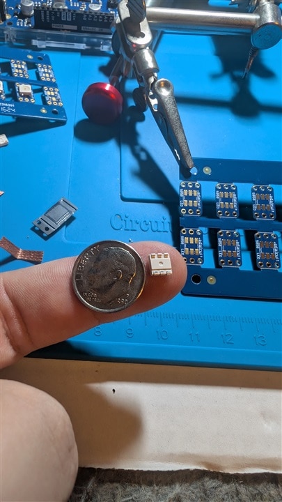

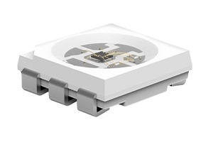

6. Würth Elektronik 1315050930246
The only other 5050 PCB-size option. It's brighter than the first which is great for a flashlight, but also has 6 pins each instead of 4, so soldering would be more difficult. I would say this is a close second place.

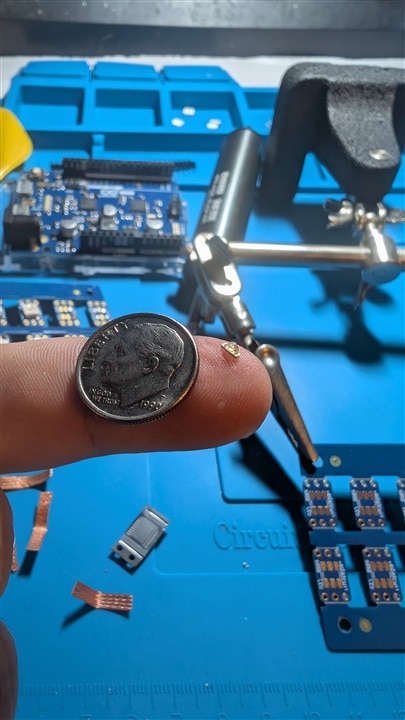

7. Würth Elektronik 1311610030140
Just too small and dim for what I need for this project, but might be my preferred option for a denser multi-LED bulb later.
