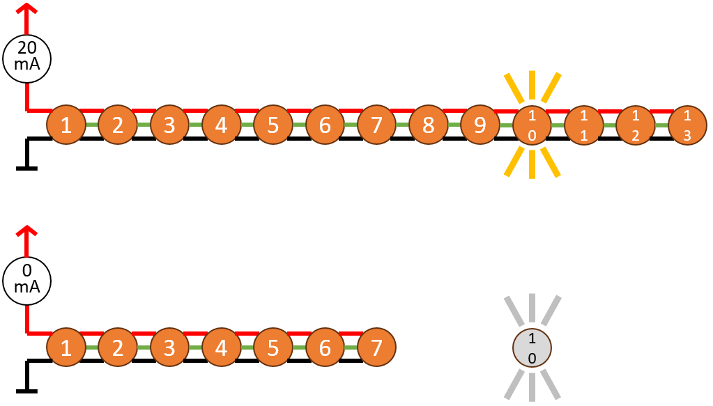

Hello. I welcome you to my last experiment before I publish final project. In this forum post I want to explain how you can determine LED strip length without knowing it’s length in advance.
Idea on this is not my own. I first time read about it here: A Nifty Tool For Counting Neopixels
It works in a way that you measured power consumption of LED strip. You hold most LEDs off except one. Idea is that you enable one LED at a time and test if power consumption grows or not.
Block diagram visualizing principle of counting LEDs on bus
For demonstration let’s consider 10th LED to be the selected one. You send bright white colour to 10th LED while remain others off. Then you measure power consumption of whole strip and compare it to idle state (all LEDs off). If it grows, it obviously must be caused by 10th LED present in chain and now emitting light with cause increase of power consumption. Now you know that strip is at least 10 LEDs long. If power consumption does not grow, there is no 10th LED on LED and you know your strip is shorter than 10 LEDs. Depending on this observation you try it again with higher or smaller LED index and sooner or later you find boundary when turning LED on increases power consumption while one LED later it does not. This is the length of LED strip.
