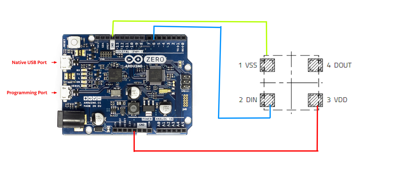

Würth Elektronik LED #1315050930002 is basically a tiny NeoPixel/WS2812-style smart pixel with 4 pins (VDD, VSS, DIN, DOUT).
1 - VSS: Ground pin, will connect to Arduino Zero pin GND.
2 - DIN: Data In. Will connect to Pin ~6 on Arduino (PWM).
3 - VDD: Power supply. +5V pin on Arduino.
4 - DOUT: Data out. Would go to the next LED in series (I think) but I'm starting with only one LED for now.
Basic circuit diagram
This is about all I'd need (save for the memory card, power input, and the optional capacitor). My soldering skills are unfortunately not up to par, so I wasn't able to actually get this working even with sample code from Arduino.
I found in interesting learning about all the different pins on the Arduino, and the differences between PWM and SPI. The Neopixel library by Adafruit has all kinds of great tools built for controlling these LEDs. I wish I had gotten the physical construction down better in time. I'll keep progressing with this though. I tried running this sample code but didn't get any output from the LED: https://github.com/adafruit/Adafruit_NeoPixel/blob/master/examples/simple/simple.ino.
