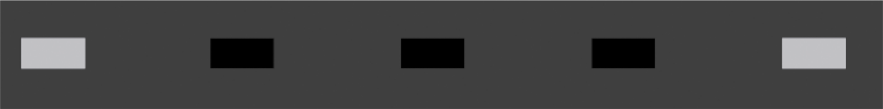

To count to 24 in binary we need at least 5 bits, so that makes the number of light zones easy to figure out: 5. But, that would only allow for hour representation, there would be no granularity, so I thought to represent 5 minute intervals with color, so that needs 12 colors, 12 colors which have to be distinct enough from each other to quickly tell qhich 5 minute interval they are in. Let's get an idea of how it would work:
Let's say it's 17:45, so, 17 in binary is 10001:

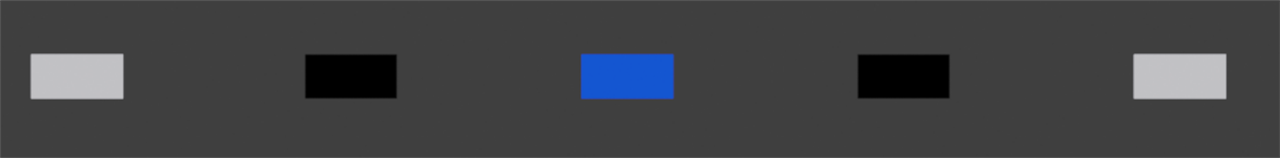

and the 45? let's make it blue for now:

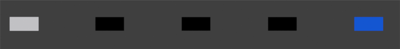

This example made me think of even more granularity, to be able to have a resolution of 1 minute by having the hour be solid white, the minute being color, but also blinking, and also using the 5 light areas to represent the minutes within the 12 chunks of 5 minutes that the different colors allow.
Let's consider 17:47 now:
The LSB is on the right, so we have 17 from the white lights, we see a blue light so we know we're in the 17:45 to 17:49 region, and we see the blue in the third light area, so we know it's 17:47. But how do we know there isn't a white light hiding under the blue one? The minute indicator will blink, so it will be on, like above, for one second, and off, like below, for another second:
