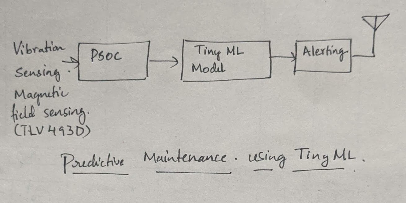

Block diagram of the solution.

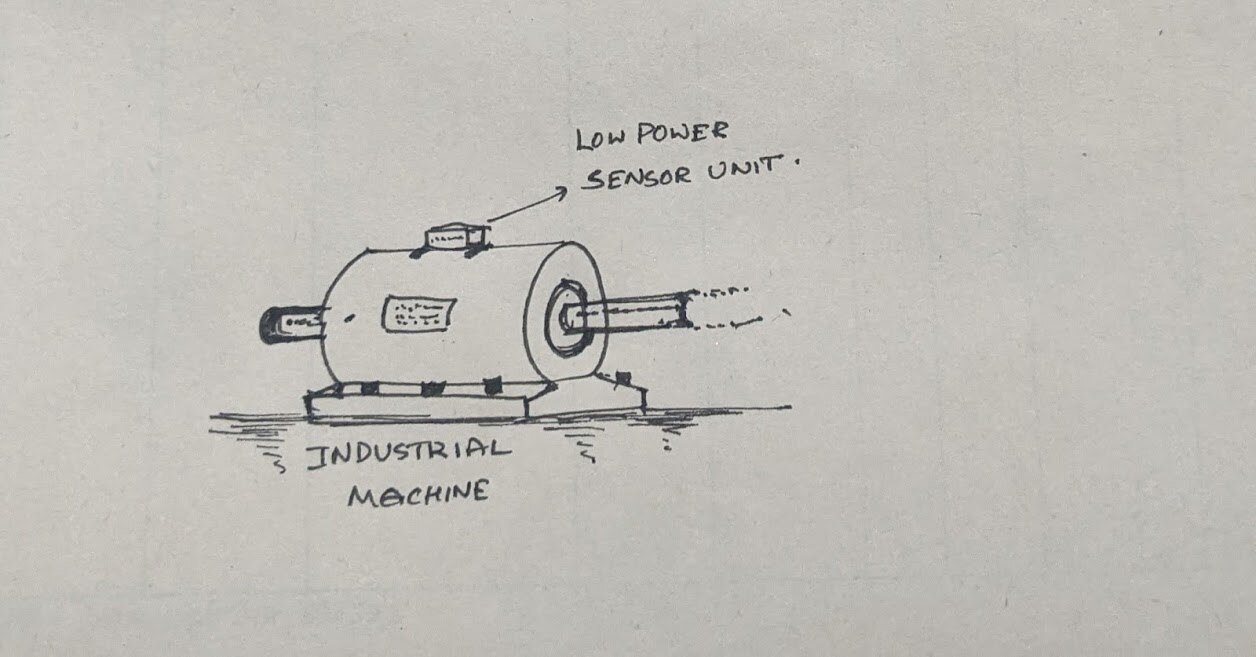

The solution involves edge computing powered by tensor flow lite to detect the anomalies using the machine learning model running
on the low power PSoCTm 6S2 + AIROCTm
This whole unit can be battery powered and only when there is an anomaly detected it can send the data over BLE to the nearest gateway i.e Raspberry pi 4 in our case.
The sensors involved: TLV493D hall effect sensor will be used to measure the change in the magnetic field. This sensor data can be used to measure the angle of the rotor at a
given instant of time. This will help us to detect the anomalies in the rotors, rpm, etc. In order to train the ML model, we will be using the edge impulse studio and the model running on
the low power microcontroller will provide the inference based on the sensor data.
Implementation diagram
