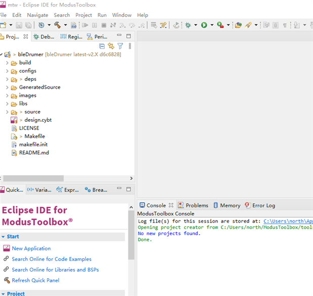

1 Create New Project
After Install Modus IDE, the creating of new project becomes easy. Just press CRTL+7 to invode Project creater, select template, middleware and peripheral. Then new project can be created.
After customized the selection, new project can be created
Another way is to revise sample project, that would be more quick, but some functions are not included, there are still a lot work needed.

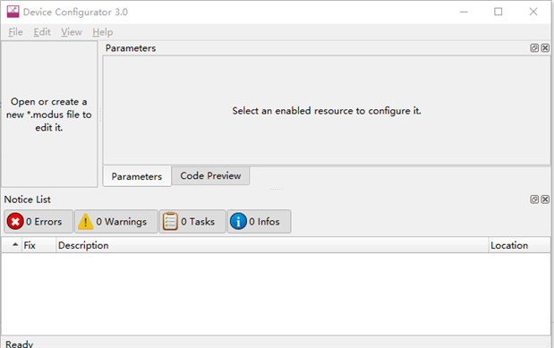

2 BSP
Becareful with BSP, there is device configurator for customized BSP, this is good for new design from scratch with electrical design. Once modified, each project shall be influeced, for this project with PSoCRegistered 62S2 Wi-Fi BT Pioneer Kit.

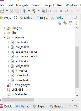

With RTOS, the scaling of the project becomes easy. Just create new task, adding in thread, then all the task can run well, I have added several tasks it runs well.
Communication between task with Created Quene, the data structures need to be clear and robust, part of the code  for LED pwm is listed below.

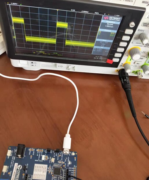

4 The Fun in PWM control
Connected with oscilloscope,here is the wave form.
