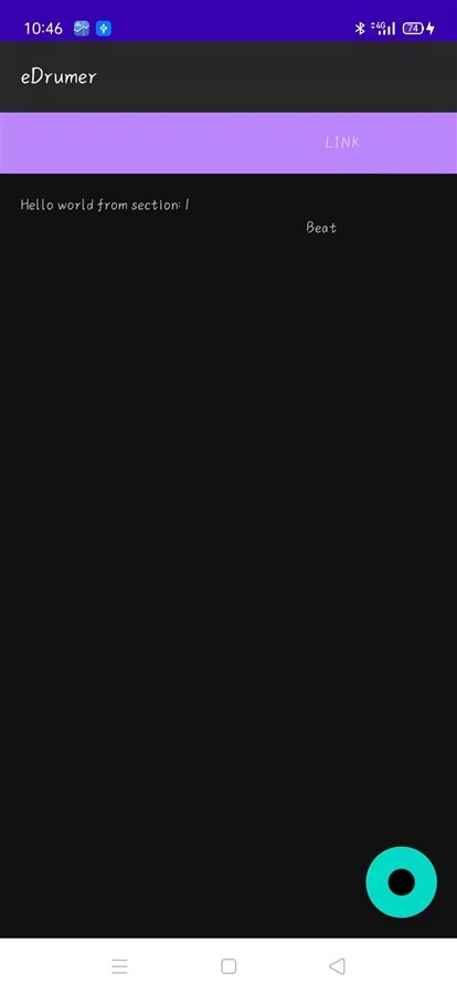

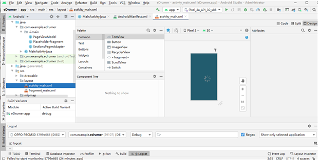

Android Studio is the official Integrated Development Environment (IDE) for Android app development, I have download and install Android studio, then create Application with default template,
with the project name of edrumer.example.com, I still keep two pages swap with finger.

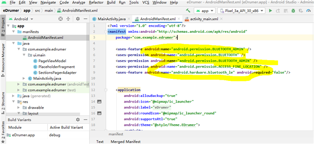

Use of the Bluetooth LE APIs requires you to declare several permissions in manifest file.
<uses-permission android:name="android.permission.BLUETOOTH"/>
<uses-permission android:name="android.permission.BLUETOOTH_ADMIN"/>

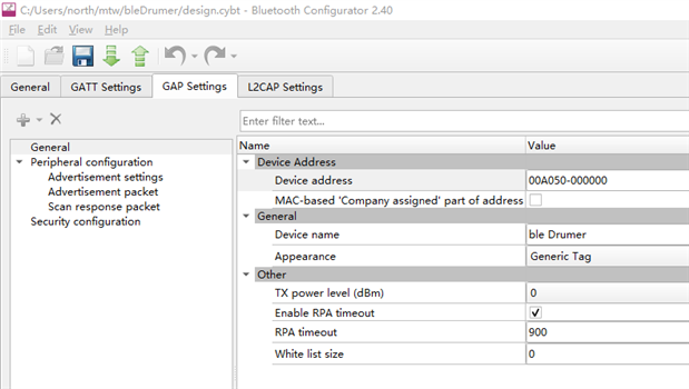

If Bluetooth is available, the device will scan for nearby BLE devices. Once a device is found, the capabilities of the BLE device are discovered by connecting to the GATT server on the BLE device. In this case the Address shall be used from the code in program
String address = "00:A0:50:00:00:00"; //MAC address...

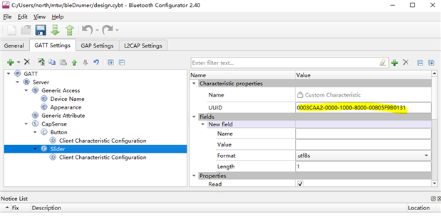

The Characteristic shall got from UUID directly with the following value,
