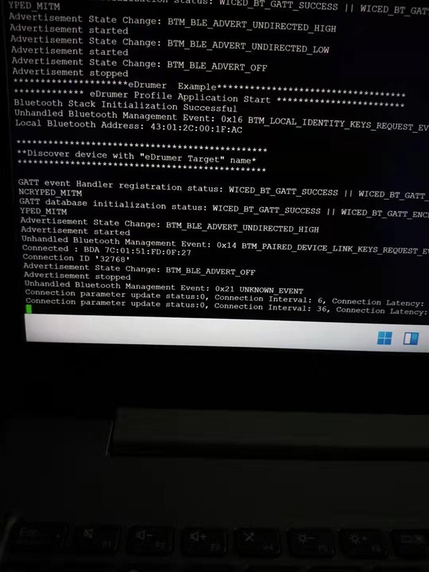

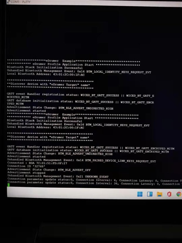

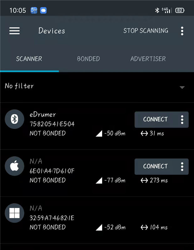

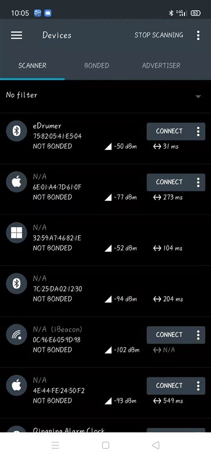

3 Connectiong with the Board with Mobile BLE app

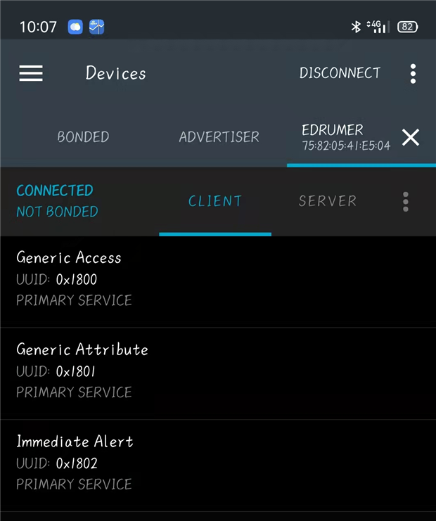

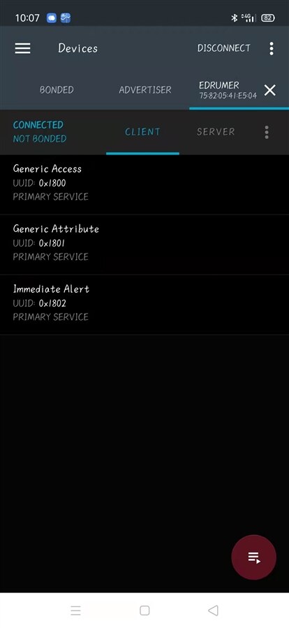

There is not enough time for better Android APP demo, normal BLE App is used . the Mobile connected with edrumer with BLE,
Then the hardware response to the control from mobile.
Once connected, enter into the PDM cycle in responsive to any soud over threadhold to flash the led and send back the signal to mobile. The android APP shall be build to receive the customized BLE characteristic.
