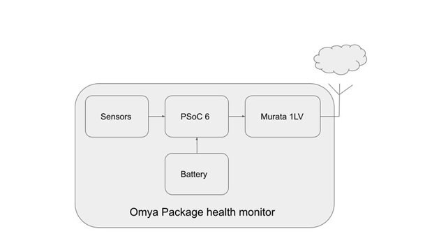

Here's the architecture I have decided on for this purpose:
The main brain here will be the PSoC MCU and sensors would be a hall effect sensor Infineon TLV-493D and an IMU sensor along with a temperature sensor
The controller will log all the data onto the device like flash or a micro sd card and will send them to the cloud when there is a wifi connectivity. This happens when it reaches from warehouse to warehouse and
finally at the delivery place. Once the network of these intelligent devices is mature enough this will be like airbags.

    shabaz over 5 years ago
    I felt why can't use the existing AC powerline and generate the required DC power
    Hi Vishwas,
    There are sometimes very good reasons not to use the existing AC powerline for power. For example, if there is a complete failure, then you may not have any backup power for anything after a 'dying gasp' type of transmission.
    Also, nearly all the commercial sensors use a separate battery, for really good and visible isolation, and to simplify connections, and in some respects allows anyone to install it, rather than an electrician (that depends on the precise scenario and the country/regulations).
