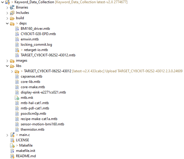

Here is the structure of the Keyword_Data_Collection application with the BSP and required libraries shown.

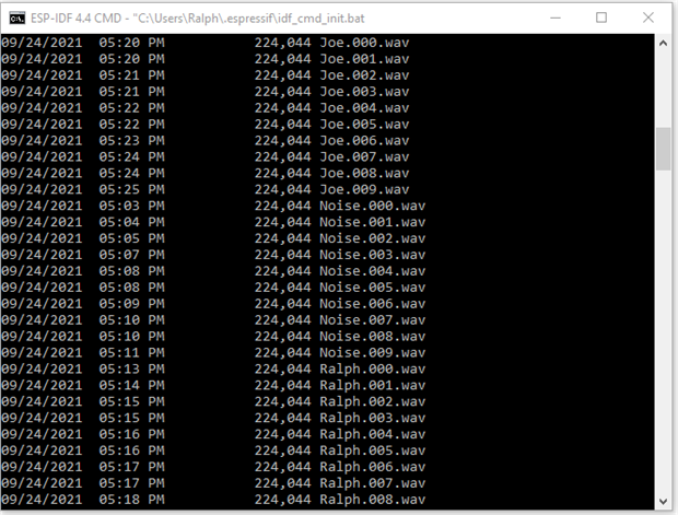

The Python script requires two arguments - the serial port and the output file label.  The script checks for the existence of the same file label and appends an incrementing number to keep the recordings unique.  The script needs to be restarted for each set of label files.  The file counter starts at 10 because I had already captured 0-9.
The result is a set of labeled WAV files that are uploaded to my Edge Impulse Project.

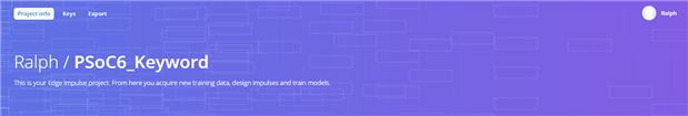

Login to my Project Dashboard

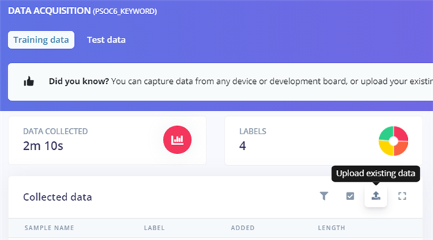

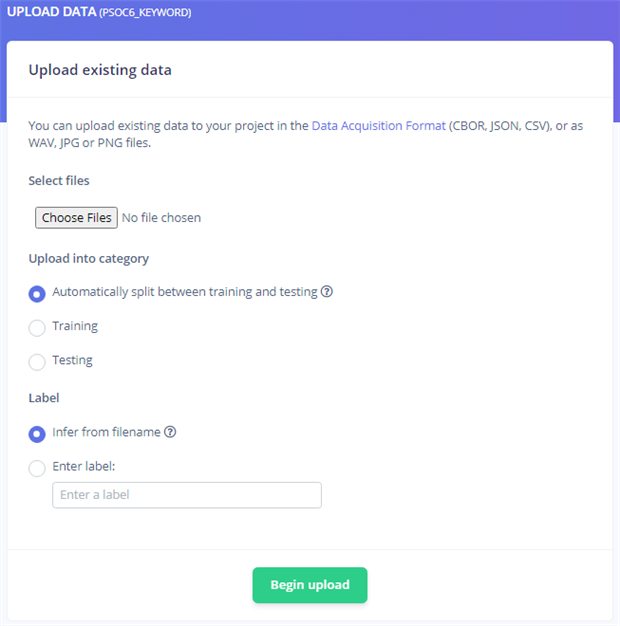

The Edge Impulse Data Acquisition Panel on the project dashboard has a button to invoke the uploader for existing data.
I can directly upload WAV files and have the labels inferred from the filename and also split into Training and Testing sets - very well implemented!

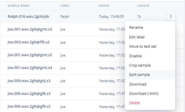

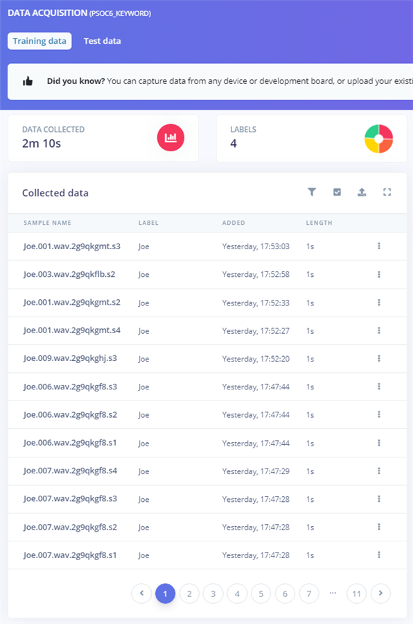

I am uploading 7 second sample files with multiple instances of the keyword.  For keyword spotting it works well to split the file into 1 second segments.
That's easily accomplished by selecting the 3 vertical dots on the right and selecting "split sample".

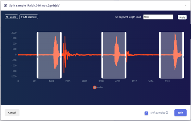

A graphical window pops up to allow you to adjust your segments if required.  It is good to select "Shift samples" to randomize the sample position in the 1 second window.  You can also deselect "bad" samples.
When all the 7 second files are split, we end up with our dataset of 1 second sample files.  It is recommended to balance the number of files per label as indicated by the color wheel at the top of the panel.

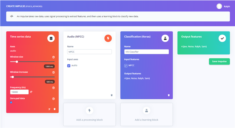

With the data uploaded, it's time to create an impulse (model).  Since this is a simple keyword spotting example, I'm going to use the default audio settings.

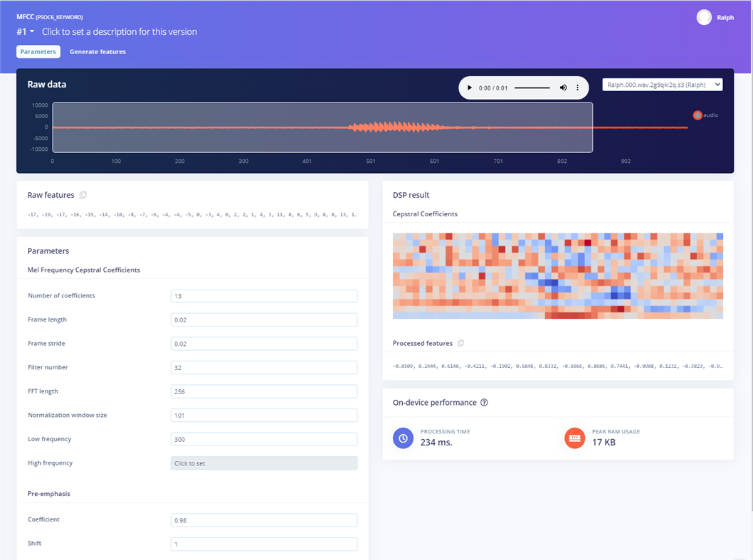

A quick check of the feature extraction using the MFCC processing block.

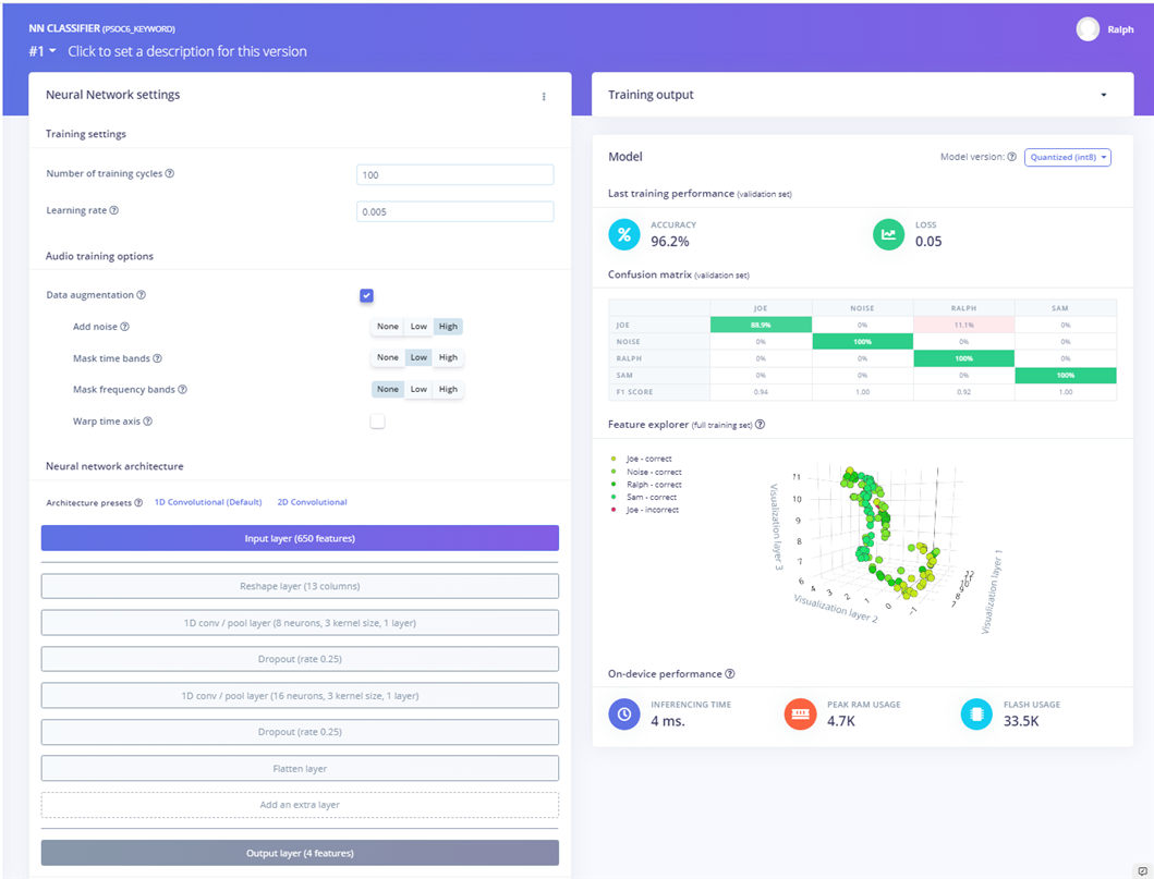

And then training the Neural Network.
Since this a fairly constrained case I was hoping for better accuracy, but the model is having a problem with some of the samples.  One thing that I noticed when I was capturing data was that I was not getting much volume from the PDM microphone.  I tried adjusting the PDM/PCM converter settings but didn't get much improvement.  This is a problem that I need to fix.  I'll post a question on the Infineon PSoC product forum and see if I can get some help.

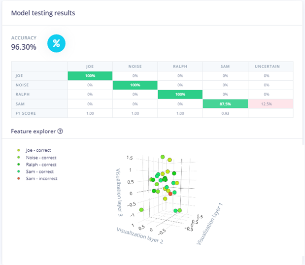

Here is the result classifying the Test Data set.  Similar results to the training data, just a different data label is mis-classified.
