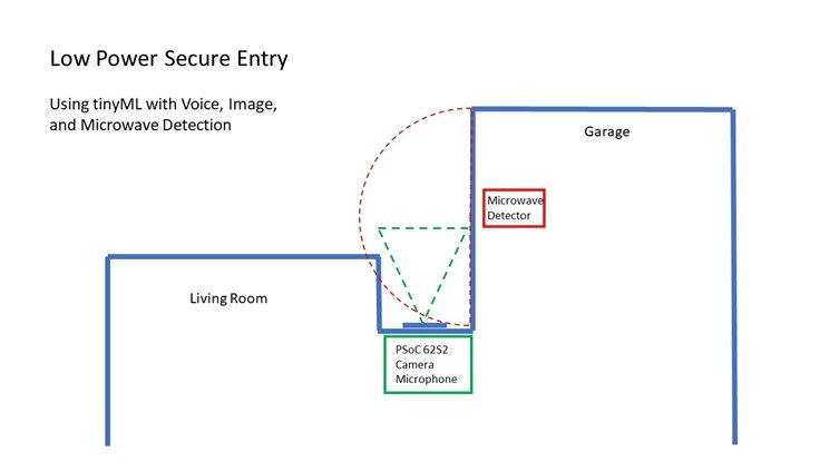

I have been working on the concept of a multi-stage security system for the front entry door of my house.  There has been a trend lately to "sensor fusion" to enhance application capability.  The use of different sensors in the various stages would allow me to optimize the power of the overall system and improve the accuracy of person identification.
Stage 1 Intrusion Detection:  This is an "always on" low power microwave sensor that would detect a person or animal entering the zone around the entry door.  This would trigger the operation of the next stage.  I designed a portable unit for my Hackster project that communicated via MQTT and I'm going to reuse that for this project.
Stage 2 Object Classification:   This would classify the detected object as a person or animal using a trained tinyML model with camera and microphone inputs.  This stage will alert via MQTT that something "live" is in the detection zone.
Stage 3  Image Recognition/Audio Codeword:   If the object is classified as a person then entry access would be granted if the person is identified by image recognition and/or an audio codeword response.
