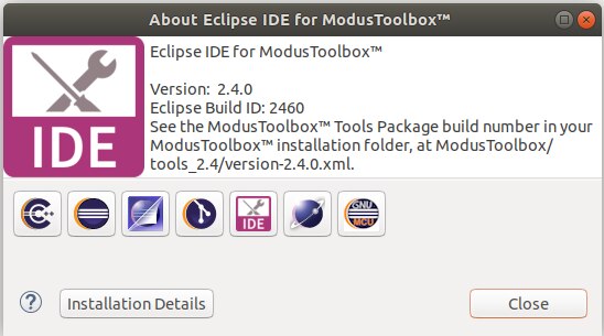

I use Linux machine for most of my projects. To be specific, it's Ubuntu 18.04 LTS. I already had ModusToolbox v2.2 and v2.3 installed but I noticed there's a new version 2.4 available. Thus I downloaded it from here and installed it. The installation is very straightforward if you follow the installation guide. One of the great features of ModusToolbox is you can install multiple versions on the same machine and can still use each of them.

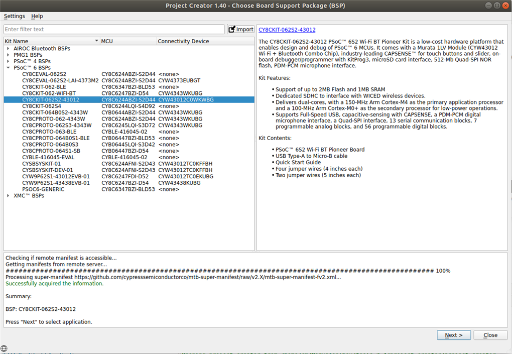

Creating a new application in ModusToolbox IDE is very simple. Just a few steps we can easily run the "Hello World" application on PSoCTm 6S2 + AIROCTm Wi-Fi/BT kit.
Create a New Application

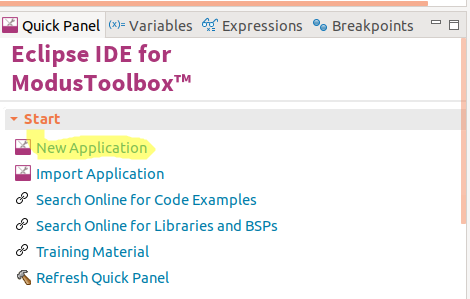

Start with the New Application button in the Quick Panel as shown  below.

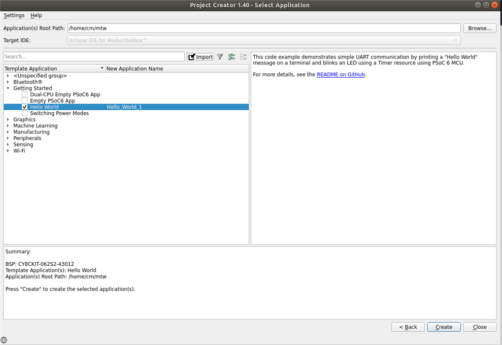

Choose the correct kit - CY8CKIT-062S2-43012 in the Project Creator window
Check on the Hello World template followed by clicking on Create button.

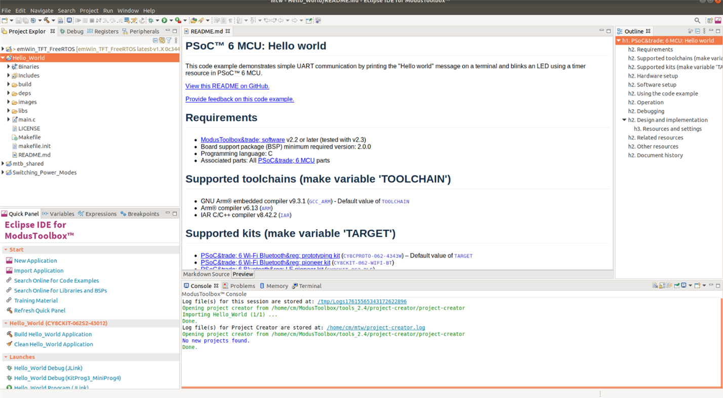

The new application is created and shows up in the Project Explorer tab.

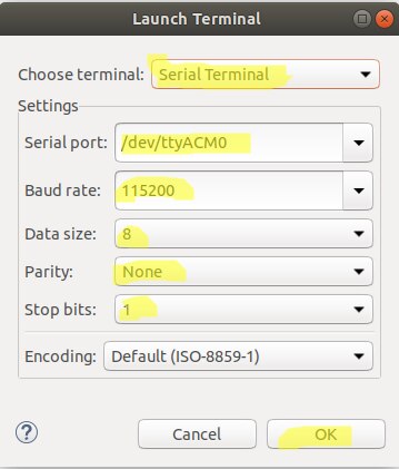

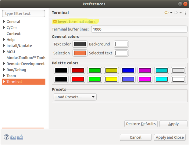

ModusToolbox version 2.4 added a new feature - you can open a serial terminal inside the IDE. Thus you don't need an external terminal software such as putty, minicom, tera term, etc. To set up the serial terminal is pretty simple. Click on Terminal tab at the lower window frame, Open Terminal button() should show up at the right hand side.image
Click on this button, the terminal set up window should show up. Use the highlighted settings below then click OK button.
A new terminal window titled with the serial port name will show up.
You can change the terminal's color. In my case, I checked the box "Invert terminal colors" so the background become black and text white.

Build & Run Application

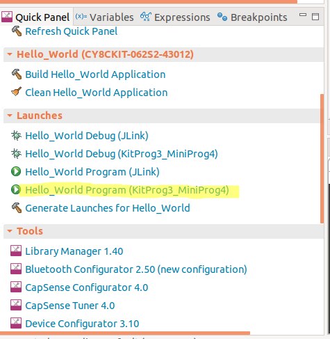

After opening the serial terminal, you can build and run the application by simply clicking on the button shown below.

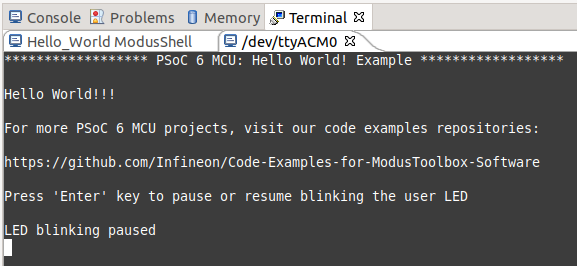

Here's the output on the serial terminal after running the application.
