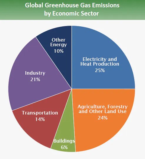

Around 25% of global greenhouse gas emissions come from the burning of coal, natural gas, and oil for electricity and heat generation. It is the largest single source of global greenhouse gas emissions.

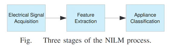

How NILM Works?
A NILM is designed to monitor an electrical circuit that contains a number of devices (appliances) that switch on and off independently. By a sophisticated analysis of the current and voltage waveforms of the total load, the NILM estimates the number and nature of the individual loads, their individual energy consumption, and other relevant statistics such as time-of-day variations. No access to the individual components is necessary for installing sensors or making measurements. This can provide a very convenient and effective method of gathering load data compared to traditional means of placing sensors on each of the individual components of the load. Traditional load research instrumentation involves complex data-gathering hardware but simple software. The NILM approach is the opposite of this, with simple hardware but complex software for signal processing and analysis. Only a single point in the circuit is instrumented, but mathematical algorithms must separate the measured load into separate components. NILM has been performed through machine learning and due to the advancement of machine learning, TinyML, and electronics, NILM energy disaggregation can now be performed very easily and accurately even using a cheap microcontroller.
