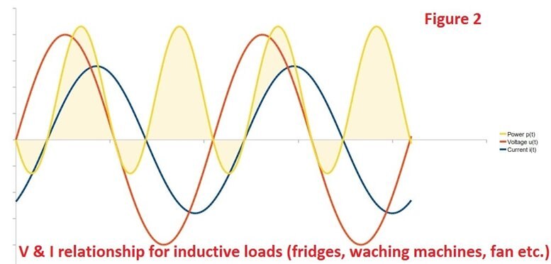

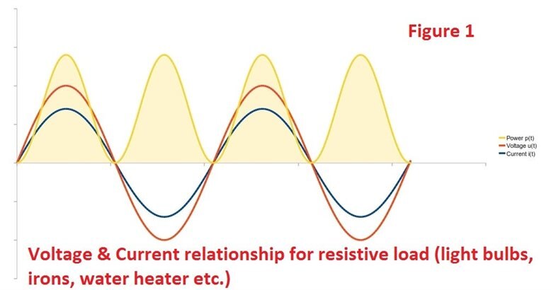

Relationship between real, reactive, and apparent power for IDEAL sinusoidal loads:
  • Real Power = Apparent Power x cosΦ
  • Reactive Power = Apparent Power x sinΦ
The cosΦ is also known as the power factor. In AC circuits, the power factor is the ratio of the real power that is used to do work and the apparent power that is supplied to the circuit. The power factor can get values in the range from 0 to 1. When all the power is reactive power with no real power (usually inductive load) - the power factor is 0. We can calculate power factor from the following equation:
  • Power Factor = Real Power / Apparent Power

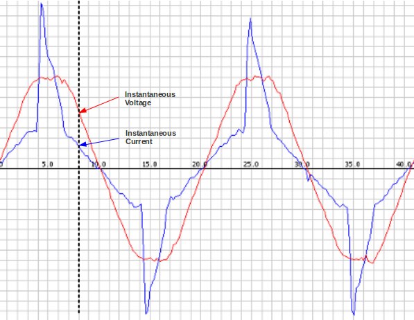

AC Voltage and current continually alternate, as the name suggests, if we draw a picture of the voltage and current waveform over time, it will look something like the image below (depending on what's using power - the current waveform - blue in the diagram below - is what you get if you look at a typical laptop power supply. There's an incandescent light bulb in there as well).
The image was made by sampling the mains voltage and current at high frequency, which is exactly what we do on our project for calculating power. We will sample instantaneous voltage and current (50 sample per 20ms). Though a higher sampling rate increases the accuracy - we're limited by the speed of the analog conversion).
Calculating real power
Real power is the average of instantaneous power. The calculation is relatively straightforward on the microcontroller program as shown in the following code snippet. First, we calculate the instantaneous power by multiplying the instantaneous voltage measurement with the instantaneous current measurement. We sum this instantaneous power measurement over a given number of samples and divide by that number of samples:

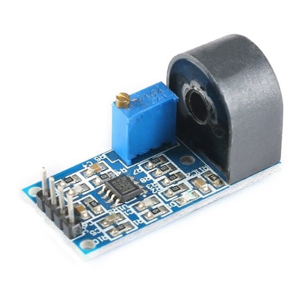

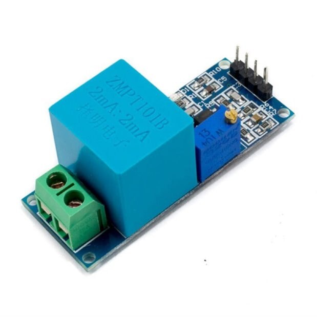

Voltage & Current Sensor
We will use the ZMPT101B voltage sensor module for measuring the AC voltage and the ZMCT103C current sensor module for measuring the load current. Both sensors provide analog data. For interfacing the sensors with PSoC 6 MCU board we will use the analog channel for data collection. We should and will use the same type of sensors for real-time detection for accurate results.
Figure: Voltage Sensor
Figure: Current Sensor
