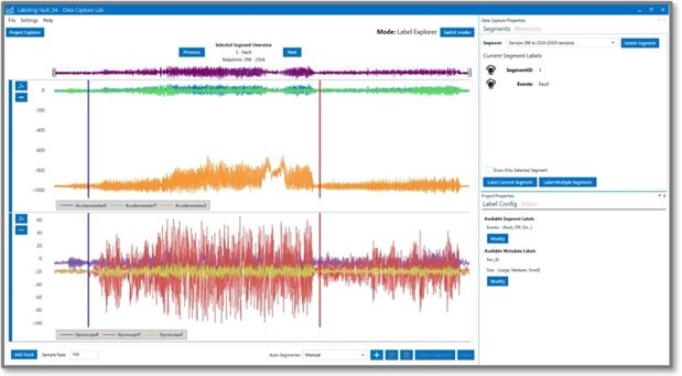

Data Collection using Data Capture Lab (DCL)
Data Capture Lab is a full-fledged, time-series sensor data collection and labeling tool that brings a level of automated dataset management developers are accustomed to in programming tools but is sorely missing in edge ML software until now. SensiML’s approach focuses on allowing developers to build datasets as enduring intellectual property (IP) that can be maintained, modified, explored, extended, and exported easily as required. And good data feeding the modeling process translates to good ML inference code as output.
The Data Capture Lab is an application that helps you capture, organize, and label raw data from the sensor and transform it into the events you want to detect. The Data Capture Lab can import sensor data from any external source if it is in a CSV, WAV, or QLSM format. You can import pre-labeled sensor data from outside sources into the SensiML Toolkit. It is a very useful tool if you have created your own protocols/applications for collecting/labeling sensor data and wish to integrate your labeled data into the SensiML Toolkit. The Data Capture Lab also supports data collection from any third-party hardware. We will use our PSoC 6 Kit for capturing sensor data.
