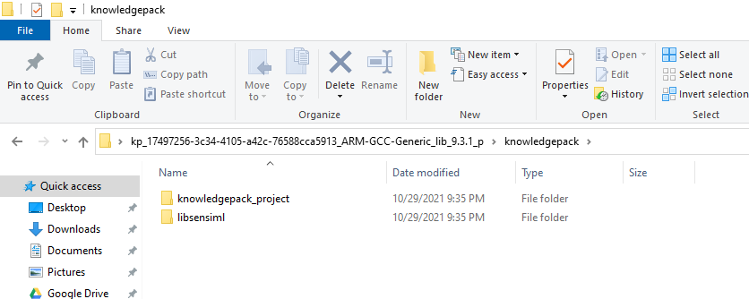

In this blog, I will show you how to deploy the SensiML model into the PSoC6 target. In the previous blog, I showed you how to download the SensiML knowledge pack for the M4 microcontroller. After downloading the knowledge pack you need to unzip the downloaded zip file.
For firmware development, we need the knowledgepack folder, and more specifically, the knowledgepack_project folder within. This contains both the library and full example code for running Recognition on the device. Downloads for other platforms will be similar, with the library file being in a folder titled libsensiml.
Regardless of the platform being used for development, these are the steps to follow:

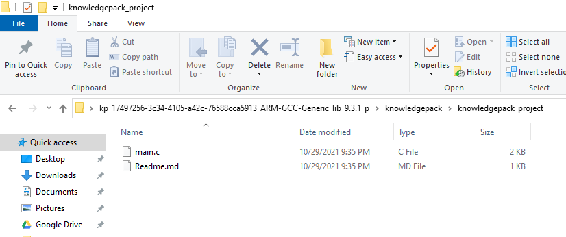

  1. Open knowledgepack_project
  2. Copy this directory to a location of your choosing in your source code (remember where you put it!)
  3. Setting up IDE workspace/project (see below for specific instructions)
  4. Add in library calls to your code.

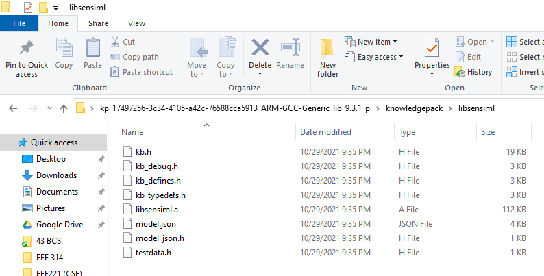

For Linking the library to your own application
1. Copy `libsensiml` folder to your desired location
2. Add an include path to your Makefile/IDE project
Running in your application
