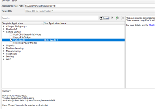

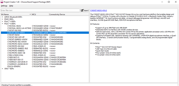

Choose th proper board before starting
Nesxt select the application you want to try out. Here I'm trying hello world just to be sure that compilation and programming is fine.

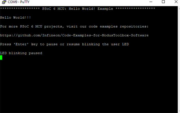

Here's the result after building and running the project. There are already many tutorials on this so I will not go through the building and running procedure again.
You can press enter key to stop and resume the LED blinking
By this experiment we confirmed that the device is ready to get the sensor data and act upon it.
