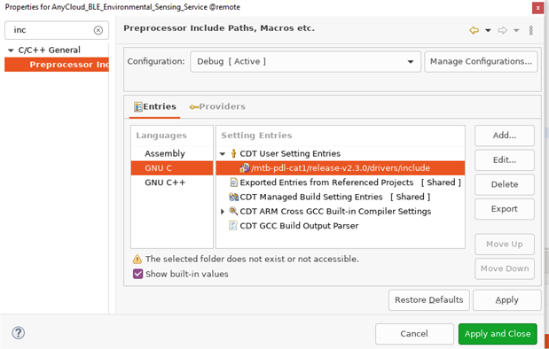

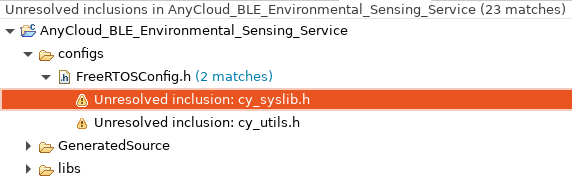

Once the project has been imported I've run the build, I've noticed an error message "Symbol 'xxx' could not be resolved".
I've identified missing includes by using "Project->Index->Search for Unresolved Includes"
And then I've added them to the project includes:

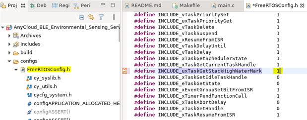

RTOS Task Stack Size
It is required to define the stack size for RTOS task. The only working way I'm aware of is an emerical. It requires to identify available memory after the task gets loaded, RTOS provides function uxTaskGetStackHighWaterMark.
But it is not available unless it is configured. So I've got the following error:  uuxTaskGetStackHighWaterMarkxTaskGetStackHighWaterMark
/home/vlasov01/airq/AnyCloud_BLE_Environmental_Sensing_Service//main.c:391: undefined reference to `uxTaskGetStackHighWaterMark'
The solution as per RTOS document is to enable it in FreeRTOSConfig.h https://www.freertos.org/FreeRTOS_Support_Forum_Archive/April_2012/freertos_uxTaskGetStackHighWaterMark_5161498.html

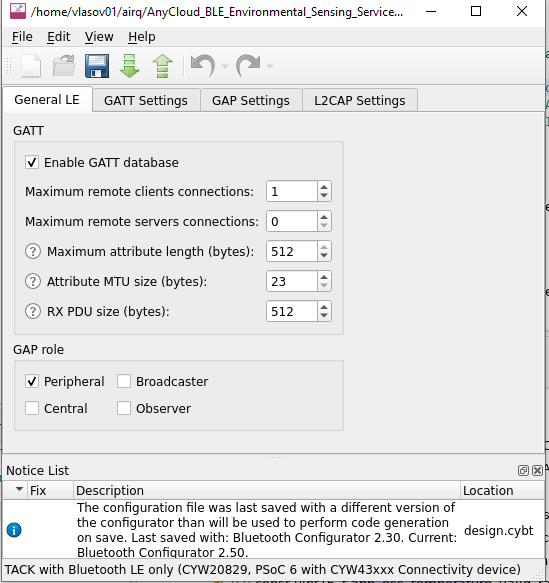

I've started the ModusToolbox Bluetooth Configurator using a shortcut in Quick Pan. It opened existing configuration for the I've imported AnyCloud_BLE_Environmental_Sensing_Service project,
I left as is General LE settings:

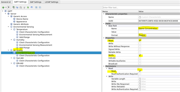

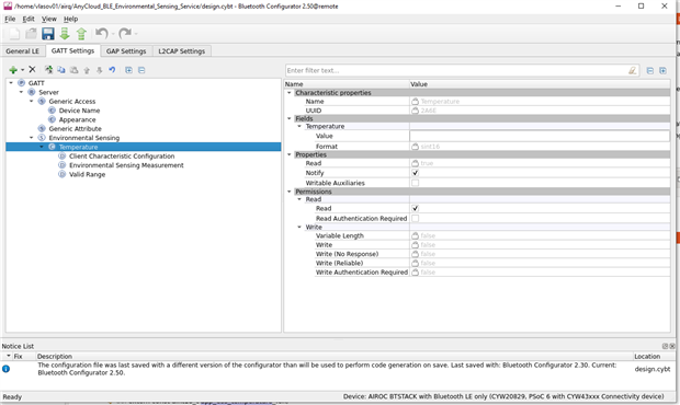

But I need to adjust GATT Settings, The temperature element came with the project.
I need to add several new elements:
  • Humidity
  • O3, ppb
  • Fast AQI a 1-minute average of the Air Quality Index according to the EPA standard based on ozone
  • EPI AQI the Air Quality Index according to the EPA standard based on ozone.
I've added them. Humidity is included in the Environmental Sensing service. The other characteristics I've added under a custom Air Quality service.

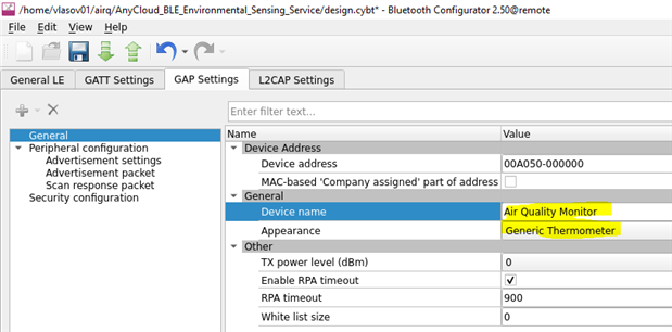

I've set the device name as Air Quality Monitor and left the appearance value as is.
After I've saved changes in Bluetooth Configurator and the Generated Sources were updated.
