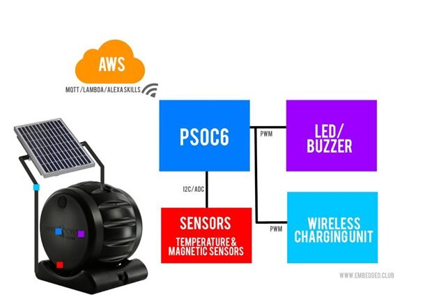

Overall Concept:

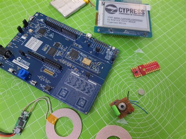

The overall concept here is to add smartness to the existing composter setup.  I'm taking the CY8CKIT-062S2-43012 Kit to which is main controller
for this entire setup. The power for the board is given from the Li-Ion battery and the battery is charged from the solar panel. Finally the board setup (PCB)
will be wrapped into a 3D printed casing box. E Ink display is used to show the composter temperature level and time. All the composter information
(spin/day left/temperature/load/level/battery) is sent to cloud (AWS) periodically. This data is used to alert /notify the user about the composter status. Also
user can access the detail via Bluetooth.
Components:
The identified components to build this project:
1. PSoCTm 6S2 + AIROCTm Wi-Fi/Bluetooth Pioneer Kit (CY8CKIT-062S2-43012)
2. TLV493D 3DSense Shield2Go (TLE493D Shield2Go)
3. MLX90614 Temperature sensor & Tilt Switch
4. Eink Display Shield board (CY8CKIT-028-EPD)
5. Wireless Charging & Solar Panel
6. Li-Ion 3.7v battery
7.Envirocycle  Composter (https://www.envirocycle.com/ )
